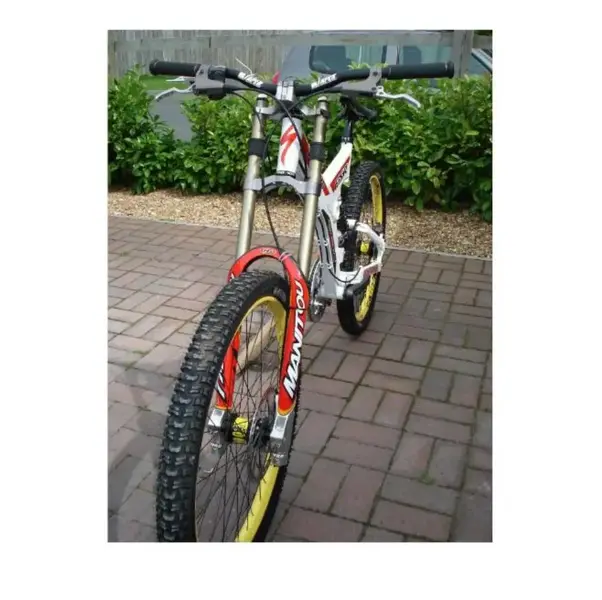

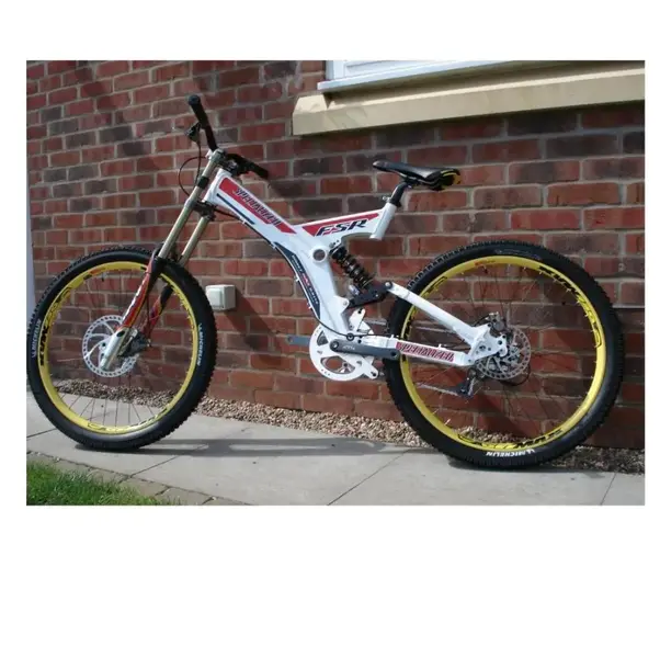

FRAME
So I started with frame. The frame in the picture was the 1998 pre production team version of the Specialized FSR Team DH. Although initial production frame did not change from the one that Palmer used, the decals on the frame did. The decals on the bike in the picture were on the team only bikes. So after a lot of talking with the guys at specialized I managed to persuade them to send me the artwork so that I could have them replicated here in the UK.
When I had sourced the frame, and I looked at 4 different ones before buying, to get the best condition one I could, I had it sent down to ARGOS to have it completely restored with team decals.
So the frame is pretty much as new, in a completely restored state. No marks, scratched etc. just a clean crisp white showroom condition frame!!!
Included with the frame is the original and exact Fox Vanilla RC shock. In almost mint condition and recently serviced.
FORKS
A pair of Manitou XVERT Carbon triple clamp forks. Sourced from Canada and again in excellent condition for there age and showing hardly any sign of use. All the decals on the forks are unmarked with no chips scratches or chunks missing.
STEM
This really is a true rare find!!! The stem used was an early MRD (Manitou Racing Development) integrated unit. This took me 8 months to even locate one and that was from the depths of the US somewhere.
PEDALS
The pedals are a pair of early Easton Cully’s and were supplied by non other than Palmers Mechanic Joe Buckley. I have proof that the pedals were supplied by Buck and there is every chance that the pedals may even have been Palmers!!
OTHER PARTS
The rest of the components included in this sale are:
1. Brand new Chris King Headset
2. Brand new original MRP chain device
3. Brand new XTR chainring
4. Brand new XTR m952 s/c rear mech
5. Brand new XT 8 speed cassette- correct ratio
6. Brand new michellin comp 24 tyres
7. Brand new XTR m952 L/H crank arm
8. Brand new Specialized Pro-Long revolution saddle
9. Brand New Ritchey seatpost, no logo's
10. Brand new hayes 203mm and 160mm original disc rotors
11. Original Protaper dh handlebars – Used but in mint condition
12. Original Hayes hydraulic brakes - Used but in great condition, just need bleeding
13. Brand new original early model Mavic Deemax wheelset
14. Used Easton Cully pedals – from Palmers Mechanic
This bike is ready to ride all bar the brakes being bled. You may not want to ride it, that is your choice!!
