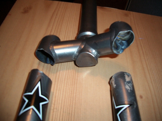

Then you should demand pictures of welds BEFORE the frame has been bead blasted or cleaned after welding. I have seen many broken Ti frames where the welds looked as your picture above, that failed due to oxygen embrittlement.
Xacd had quite a poor reputaion when it comes to forks produced pre 2004, which had a tendancy to snap (they were made for Sibex and Spicer).
There are various stories around why they snapped, from tube thicknesses to contaminated welds. I think it may be a bit of both, you can see in the picture above that both fork legs snapped at the bottom of the weld joint, so it is proberly a contaminated weld in this case. However there are other examples where they snapped further down on a single leg, so the tube thickness is more likely the cause.
I've not heard of a snapped Xacd frame (yet), only this design of fork which was a bit of a copy and doesnt seem to have any design work go into it.
