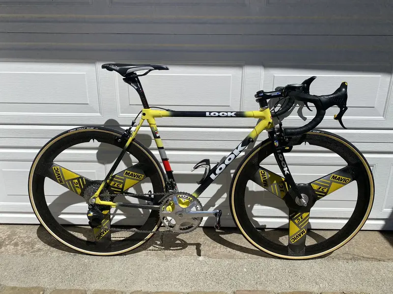

Hi Matt
Thank you for replying and glad to hear you are on the mend. Yes I found a pair of Mavic 571/2 HG hubs for approx £200 in the summer and swapped out the cassette freehub onto my Mavic 3G hub and it worked a treat so I now have a pair of mint Mavic hubs (I used to race these hubs all the time in the 1980’s) with the uni glide spare but can’t use that on Mektronic as it’s 9 speed only…also as a backup I’ve got the sunrace screw on 9 speed freewheel on a screw on Mavic 3G hub that works fine. The Look bike with Mavic Mektronic and 3G trispokes certainly gets some looks when I’m out on it.
All the best
Darren
