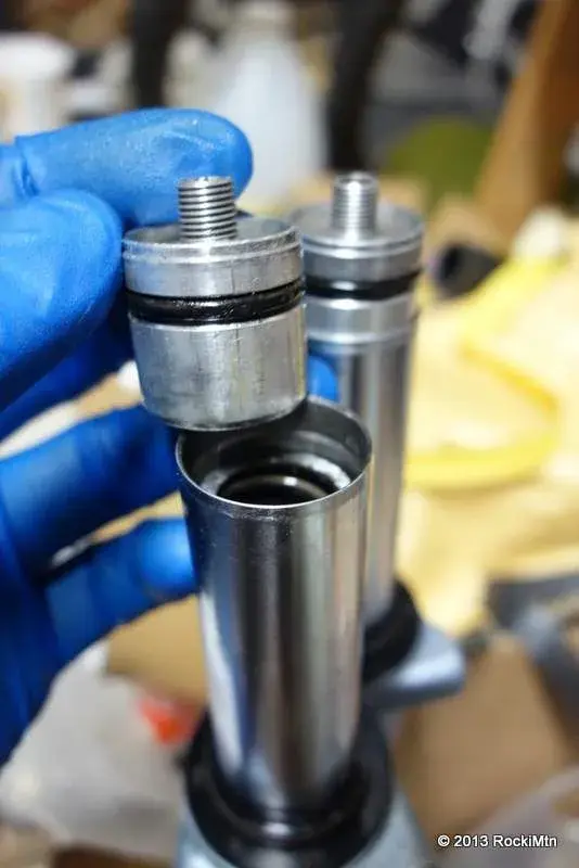

Oryginal oil is 20W, I'm using 15W as well but 7,5W will be def not good
This tool helps to remove plug - I'm just exhale air form fork, pushing the plug a bit into the stanchion, then removing cotter and pump the fork very carefully - presure will remove the plug, but You have to do it carefully!
you weren't kidding when you said "CAREFULLY"!!! :shock:
popped them up like a cork out of a champagne bottle. startled me right good! first one out i could have easily hit myself in the face and hurt me quite badly. :?
thanks!

The same setup is used on the bombers with the valves at the top. My 2001 air lite or some name like that. Just machined to a larger diameter.
