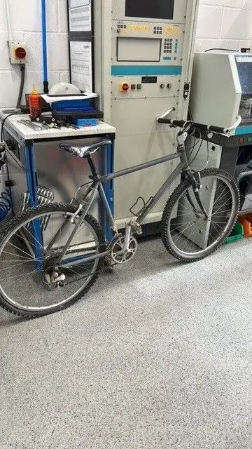

Decades ago, I gave away my first MTB to a mates father, who used it for work, getting to the allotment, and general hack. It spent the last few years buried in his shed. All things pass, & today it was returned to me.
It is pretty much as it was. My 90s upgrades are still there - Shimano headset, XT rear mech, bar ends, XT hubs.
Can't remember If I fitted the Vee brakes or not.
The wheels have been rebuilt with a later set of Mavic 317 rims after it left me. A Girvin flex stem, 728 sti units, which are fairly horrible, along with Deore Vs. Specialised saddle.
Rather than it going down the tip, I am going to rescue it. I have a few bits and bobs. A set of BRM 734 XT cantilevers, a pair of BL-M733 levers in black.
So the question is: What shifters could I use? I very vaguely remember this being the original Rapidfire when it was new. Stem - that Girvin I think has to go. So I need a black Marin stem with a roller? I think its a 1" threaded fork. What other bits can you spot? I have straddle wires etc. I must have a Flite somewhere.
The rust and chips in the shitty Zolatone paint are staying, as are the worn ODI grips etc. I wont replace the decals, as they fell off within the first couple of years. Can I still get those grey jockey wheels for the rear mech? There is virtually nothing left of them. 7 speed casettes?
Cheers - Chris.
Ace getting your old bike back. I enquired about mine that my brother in law bought bitd only to be told it had gone in a skip the week before!
As for yours, post a wanted ad on here and you will probably get what you want cheap enough, especially the Shimano kit. The original 400lx shifters should also be easy to source as would be the almost identical LX version. Other option is obviously Deore or XT thumbies. Keep an eye out for a full bike to pinch parts off as snotty BV’s don’t tend to sell for much and could easily provide the bits you need.
91 sounds about right. Shame your old bike got binned. When things fell off or wore out, I replaced with XT if I had the money - which was not often. Will give the bike a clean & see what it needs. As you say, they are not expensive bikes. Are there many functioning Rapidfire XT brake & shifters out there, or have they all packed up? I'm not intending on doing any proper off road riding on it. Just want it to all work nicely.

Looks like a 91, as said (darker Zolatone). Personally I'd fit thumbshifters as they are simple and last forever. 7s cassettes are still available, the SRAM ones are nicer than Shimano which are now generally black painted with garish logos.
