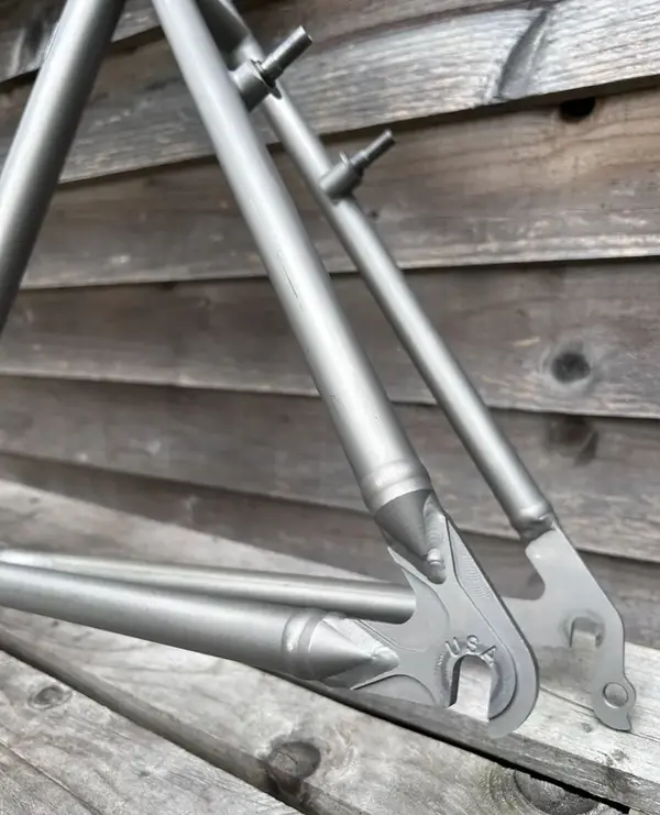

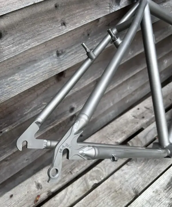

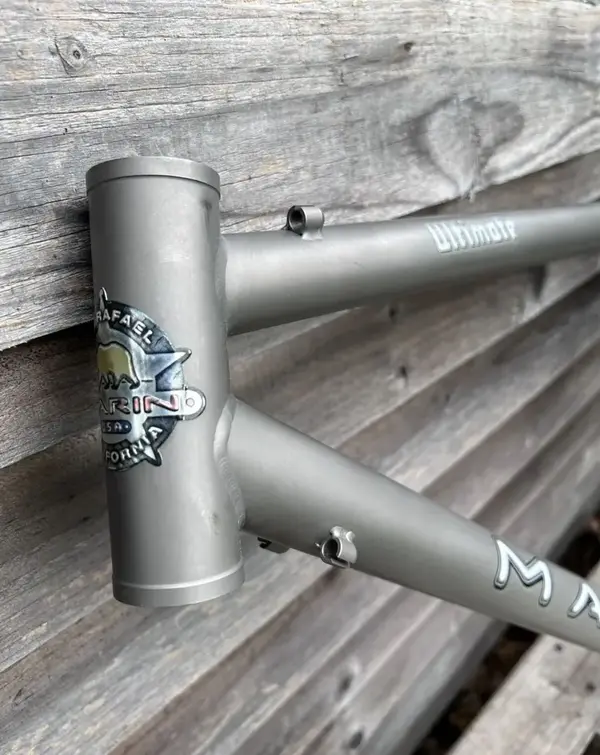

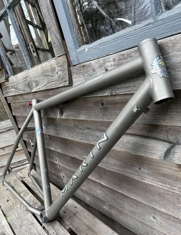

So I pulled the trigger on this frame;
I had no idea that there was a 1996 Ultimate Titanium; however the decals and logos are correct. The frame has the USA stamps so is lightspeed correct.
Has anyone any idea on how this would have come from the catalogue. ? Maybe a frame only option. !!??

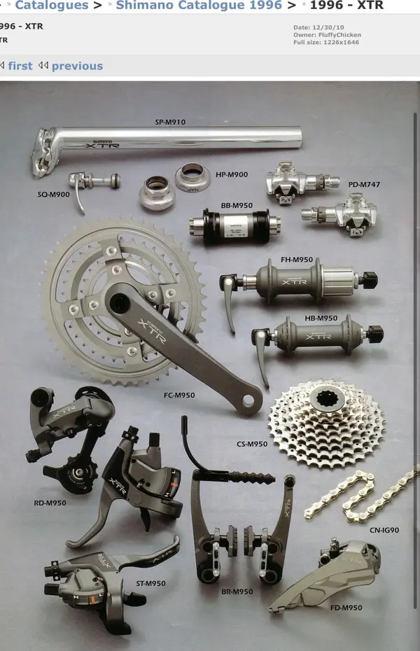

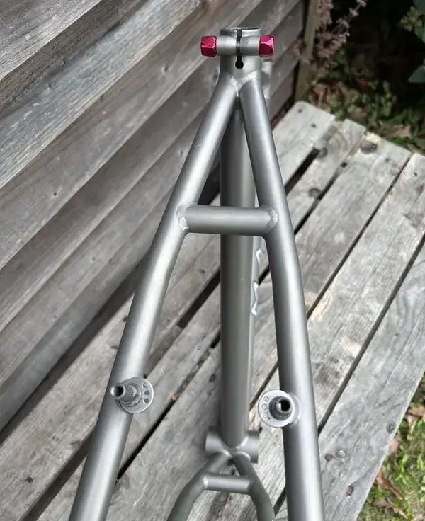

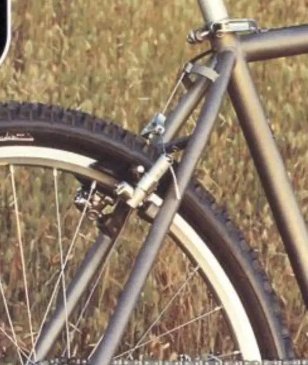

I see there is no canti cable guide at the rear so I assume was running 1996 v brakes. ? Maybe 96 XTR ? The 96 Team Titanium and 96 Team Marin have the canti cable hanger
Anyone with any insight would be gratefully received.
Thanks
Matt

It is a conundrum.. i was looking at it too.. and also through the various catalogues. The best I could dig up was that “Ultimate” was just an up-spec’d Team Titanium. In other words, same frame, but with more chi chi parts..
I had thought it might be a Litespeed built frame, as per earlier Ti Marins but found nothing conclusive.

Not quite.
The Ultimate appeared in 1994 and as well as being a super spec’d up bike; the frame was built by lightspeed in the USA as opposed to Taiwan.
The fact that it’s got the USA stamped drop outs and bottom brackets is a sure thing.
I didn’t think the Ultimate was made later than 1994; so finding a 96 variant means it’s super puzzling.
The 1994 variant was £3750 so they didn’t make very many.
I’ve pinged lightspeed the frame number so that will help a bit.
The 1995 Ultimate was a frame only option.
So I’m guessing the same applies to the 96
