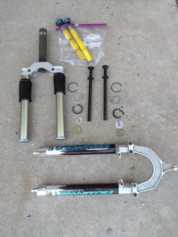

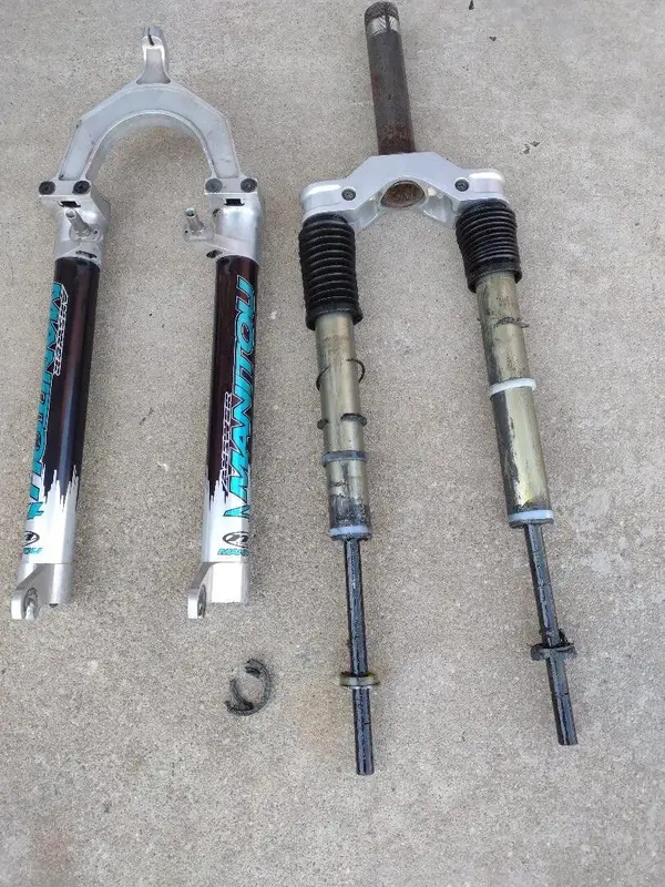

If you've not seen it, check there isn't a top out bumper in the stanchion, often get 'stuck'in there, there should also be a similar bottom out bumper from the black rod.
