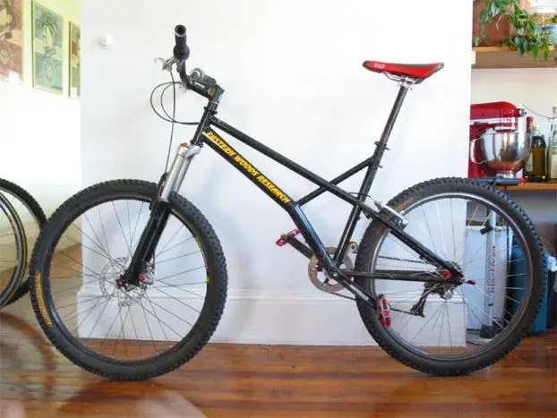

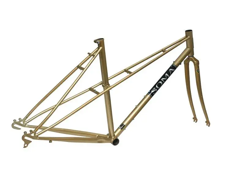

I guess you won't find much love for step-thru "crapola" frames in this forum. The closest thing that comes to my mind would be a Soma Buena Vista women's specific frame. Decent quality, looks OK. Personally I would go for a cooler low top tube design like a Eastern Woods Research frame or a Groove Innovations (offer you almost the same step-thru capabilities while being a million times cooler... but that's my opinion).
Yeah, I've noticed that in the bike world there are still very strong regional preferences regarding bike design or componentry. In the "anglo" world (mostly US and UK), racing orientation is quite strong, and since most bike multinationals come from there, bikes reflect this trend (that Sheldon Brown and Rivendell's Grant Petersen have always fought against, as it deprived consumers of everyday bikes, therefore stopping cycling from becoming more popular among beginners). Luckily this is changing.
Personally I would go for a cooler low top tube design like a Eastern Woods Research frame or a Groove Innovations.
That Groove Innovations bike reminds me of some early 90's cool Alpinestar models....!
