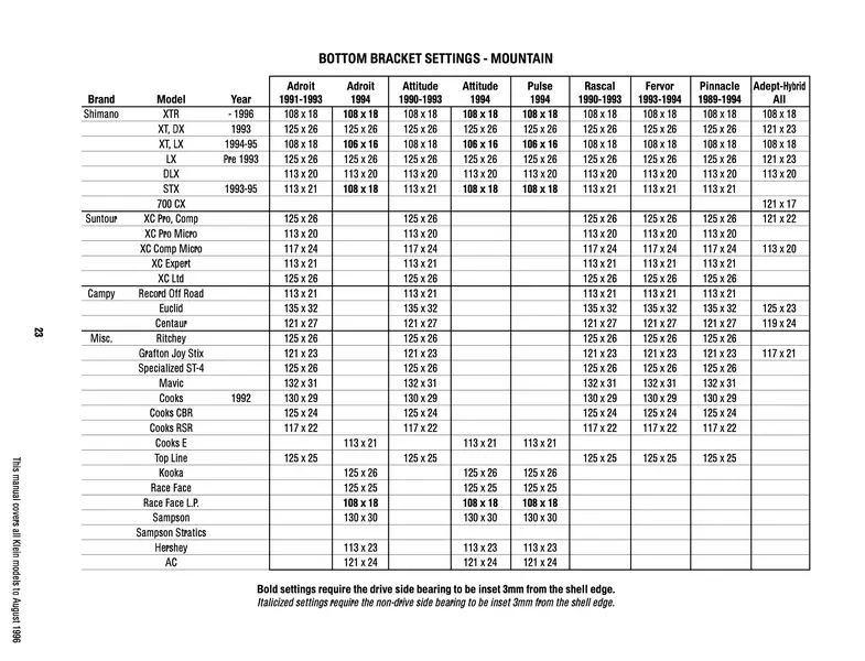

M Miles Devout Dirtbag Jun 12, 2023 #1 Hi, Does anyone know what length spindle I would need for a 1992 attitude and Kooka cranks. The spindle it has at the moment is fine for XTR M900 but too small for the Kooka cranks sadly... Anyone know where I might get one? Kind regards, Miles
kingoffootball Retrobike Rider Gold Trader Feedback View Jun 12, 2023 #2 Depending on the model, 117.5 or 122.5, I think.
M Miles Devout Dirtbag Jul 2, 2023 #3 kingoffootball said: Depending on the model, 117.5 or 122.5, I think. Click to expand... Thanks!
Star12 Gold Trader Feedback View Jul 5, 2023 #4 I successfully used a 119 mm on mine with Kooka cranks. I have a 117 mm titanium spindle for sale at the moment if you need that length. Star12
fguki Senior Retro Guru Jul 5, 2023 #5 I am currently producing new KLEIN specific spindles in all available (needed) lengths. If you are in need of any, please get in contact. Steel, V2A Stainless Steel and even Titanium versions are possible! Prices vary heavily depending on your desired material. Here is a 119mm Stainless Steel example. All axles come with a free pair of Stainless Steel ball bearings. 119mm KLEIN Adroit Attitude Rascal Quantum Pro Achse Spindle V2A Nagelneue Fertigung KLEIN spezifischer Tretlager Replacement Achsen. Material: Edelstahl! Auch...,119mm KLEIN Adroit Attitude Rascal Quantum Pro Achse Spindle V2A in Niedersachsen - Wunstorf www.kleinanzeigen.de Cheers
