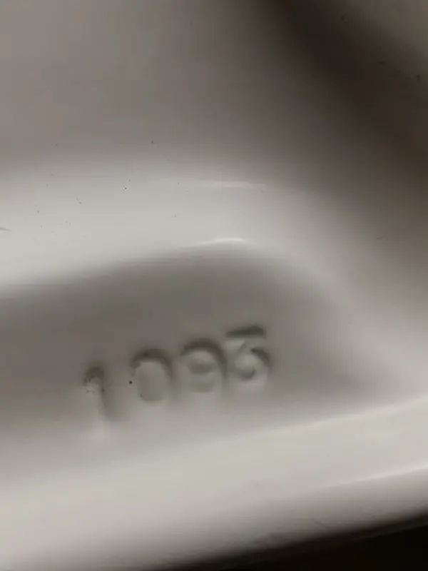

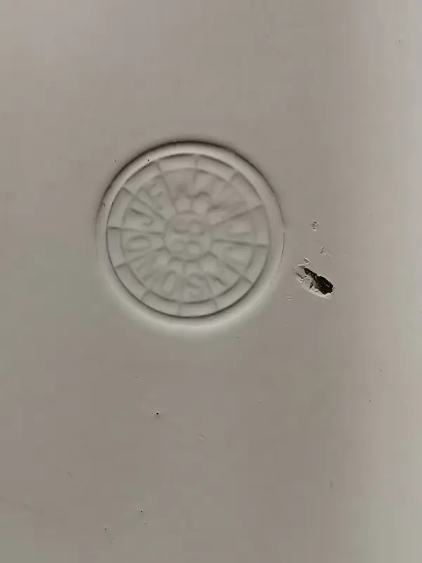

Cheers, any ideas on frame numbers and dates?
