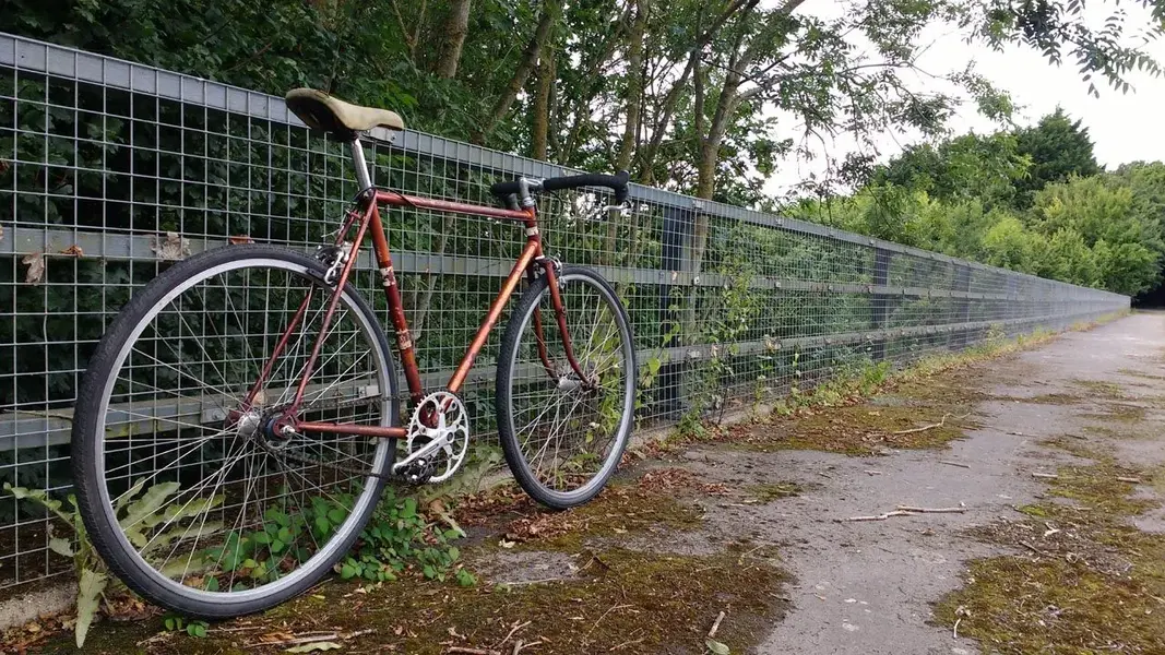

Mick I'm trying to get this old Raleigh built in time for this ride and just wondered what kind of gearing you're running on yours? It's going to be single speed and I wasn't really sure how to gear it as I'm more used to mtb's.

Hi Tim, at the moment mine has 42/18 which us a bit undergeared really but I've had a problem with my knee so will probably leave it as it is for a while ;) but a fit young thing like yourself should be fine with 46/18 or 46/16 if my knee was ok then I would be going for the 46/16 at least on this ride, it's a try it and see thing really.... Know anyone with a ss you can try?

That's kind of what I thought, thanks Mick.
Ok I haven't had time to paint this bike mainly due to stripped threads on one crank, a funny shaped bottom bracket which I didn't have a tool for, a brake which wouldn't reach the rim as the wheels are the wrong size and a stuck seatpost which I had to remove with caustic soda. But it is working and I have been out on a test ride and it actually goes quite well so I'll be there on Sunday.
