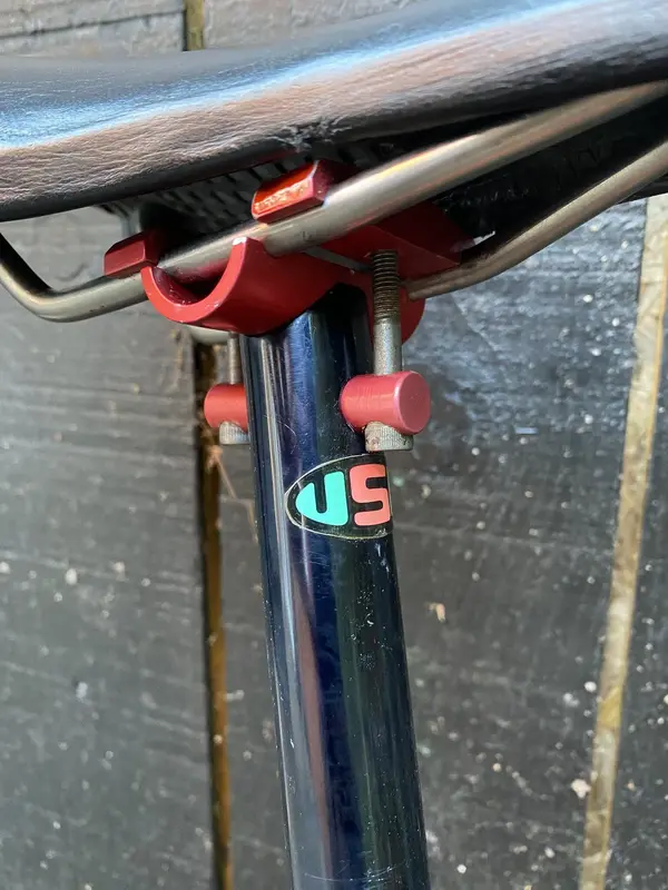

Is my USE seatpost going to kill me?
Im running a Ti modern USE post on my gravel bike / and a carbon one on my winter and it’s a very similair design to their old ones. Done loads of miles on it and its been faultless but it’s only 2-3 years old. The design can’t be that bad if they are still using it all these years later

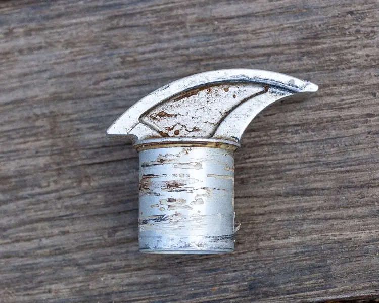

Regards the failure of my seat post it was tightened using an appropriate torque wrench, it failed at the obvious point of stress in the post where the round bar goes through the seat post shaft. Interestingly there was an aluminium insert bonded into the post down to the point where it broke.
I did look for a replacement Ti post for a while but eventually bought a Thomson.
I had a use Ti seat post in my hei hei, it snapped at the rod that you tighten the bolts to the under saddle rails after creaking for a few months.
And that's the point - if you hear creaking then investigate it. It was the sound of a fatigue crack spreading.
Yes I broke a bolt on mine - it had probably done 20 years of service. For the cost of a bolt I now replace them as a matter of course every couple of years. It's a highly-stressed part. We have to remember that a lot of this stuff is getting old, and in the case of aluminium components they have a finite fatigue life (unlike steel).
I have ‘retired’ the USE post that was on my ‘88 Cinder Cone after the one on my audax bike failed catastrophically without warning - spilling me across a Sussex lane. Upon inspection on removal the rail clamp parts had begun to warp. I count myself lucky - things could have been worse.
