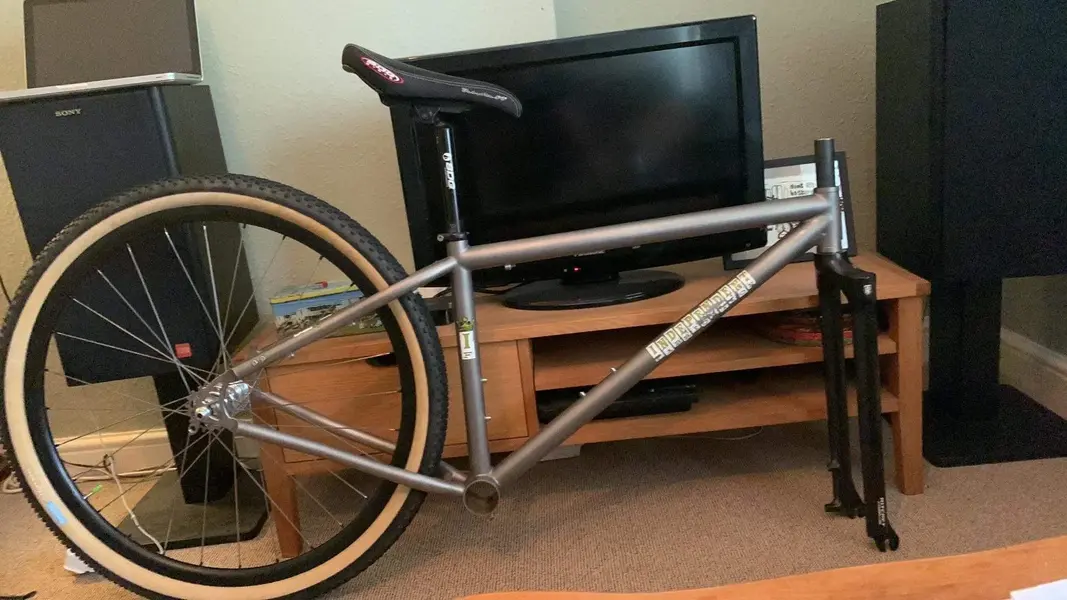

Progress - but not much
Ritchey WCS Carbon forks
Chris King single speed wheelset fully serviced at Bromley
Rene Herse Fleecer Ridge
SDG post and saddle donated from my Merlin which now has an ENVE post and new SDG Bel Air 3

Not much of an update but I sold the CK wheels as I have a set of Hope Pro4 which I rebuilt, one set had to go.
New Cane Creek 110 headset bought, new Problem Solvers ECB (damn expensive) and, well, Mr Boone has my order
single-speed-double-step-sprocket
I also bought some Deore brakes which seemed great value and will provide all the stopping power I need I think

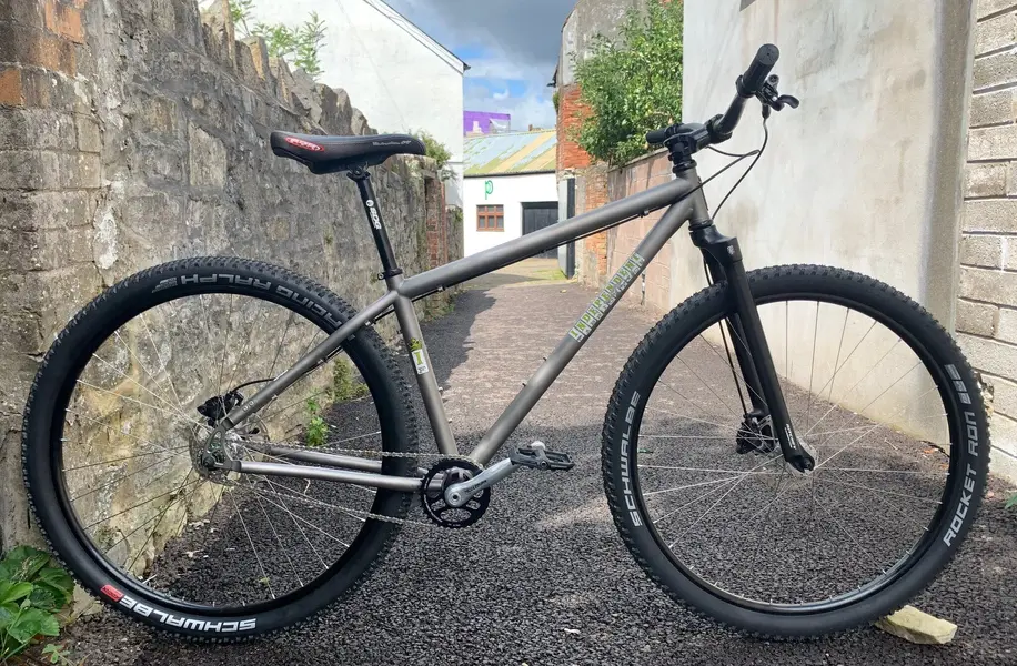

Good tip - I’ve gone back to ‘normal’ carbon Chromag Cutlas to see how they feel.
Well it’s taken a while but it’s finally finished bar a few tweaks - wee spin this morning and a big grin returned to my face, such a fun bike to ride!
2010 Indy Fab Ti Deluxe Frame
Thomson stem
Chromag Fubar carbon risers
Ritchey WCS full carbon forks
SDG post and saddle
Hope Pro 4 Evo hubs on Stans S1
Problem Solvers EBB
BB93 BB
Middleburn RS8 with hi-lo direct mount chainring
Bruce Boone titanium cog
Modest but functional Deore brakes
