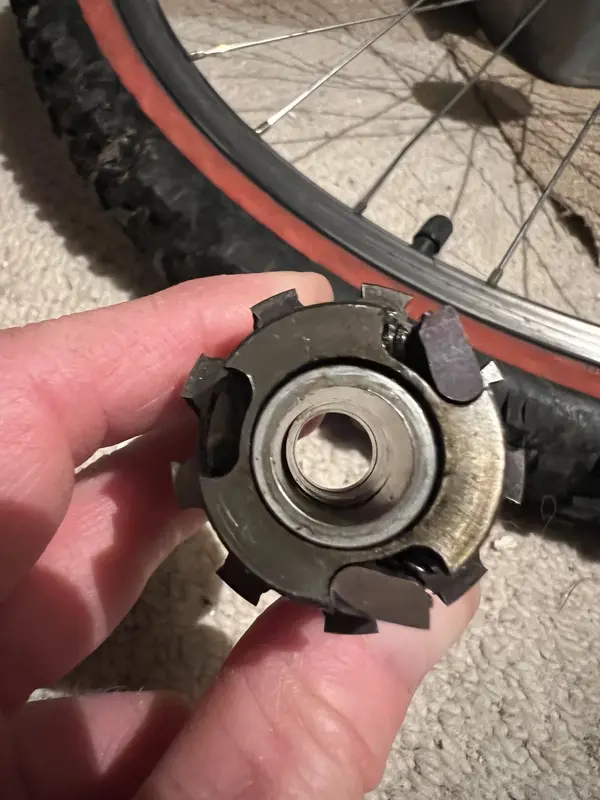

Hi,
I have an old ti-glide working with just x2 spring/pawls in the hub. I’m keen to get another in there as it should be.
Hope Technology have told me they no longer have them for sale so I’m on the hunt to see if anyone has them in their spares tub 😂
Thanks in advance.

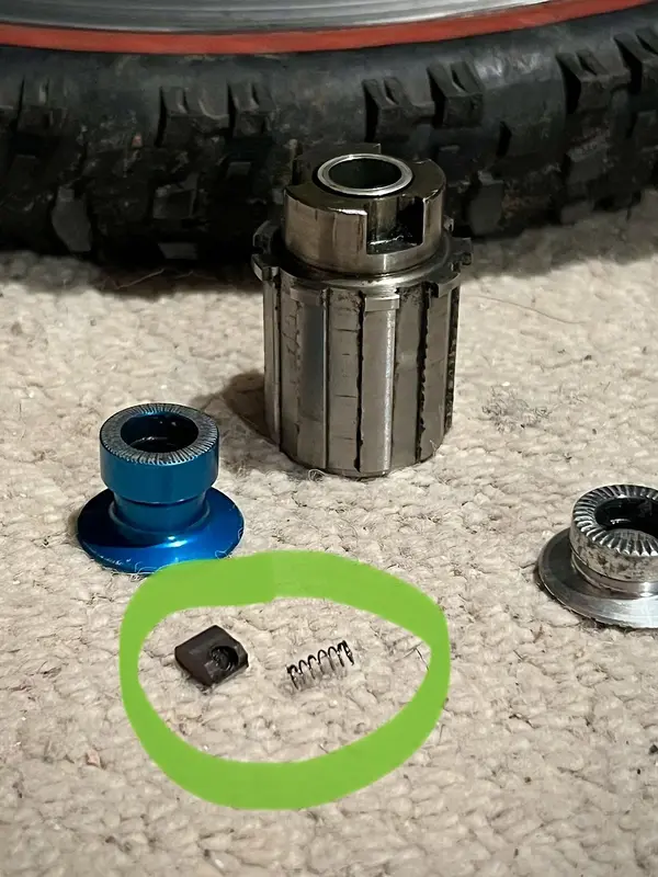

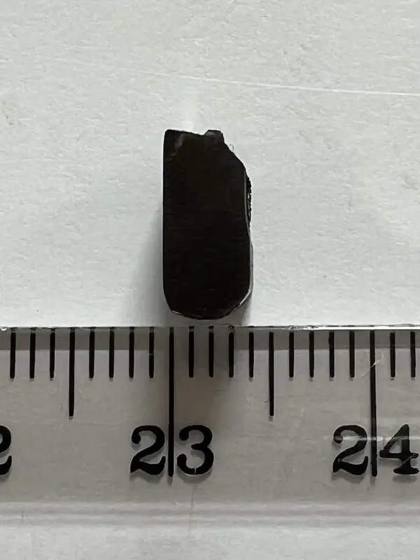

I have some in the spares box. Top one is 4.6mm thick and the lower is 4mm. judging by your picture, the 4mm one is correct. 20230217_091647.jpg
Ah nice one! I agree, reckon 4mm is the one.
