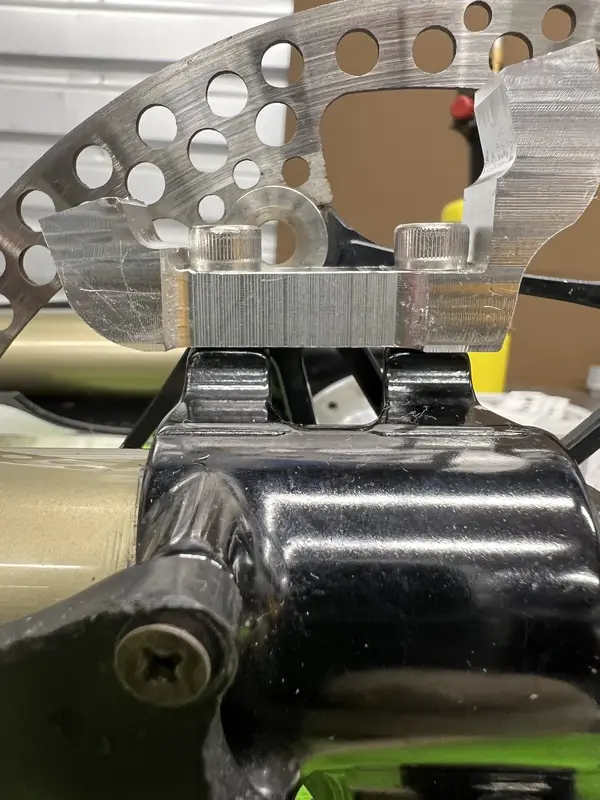

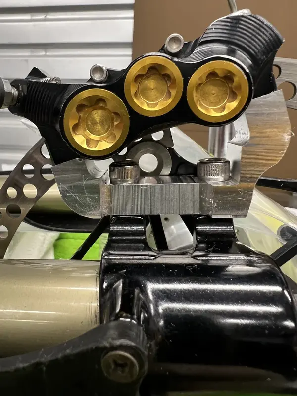

I emailed Hope. No luck. I ended up making one. Almost finished tonight. Just need to do some smoothing and maybe some reveals or slots for looks.

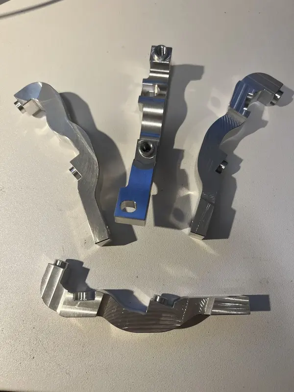

Just saw this group from Googling. I have made this mount by laser CNC. I have a few extra from the run. They fit the Hope Mono 6ti perfectly as that is what I made them for. Part # HBSP149:MAR
Located in Vancouver Canada
