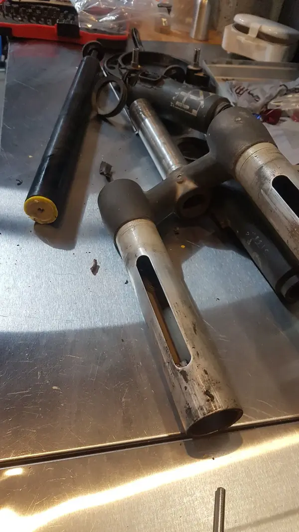

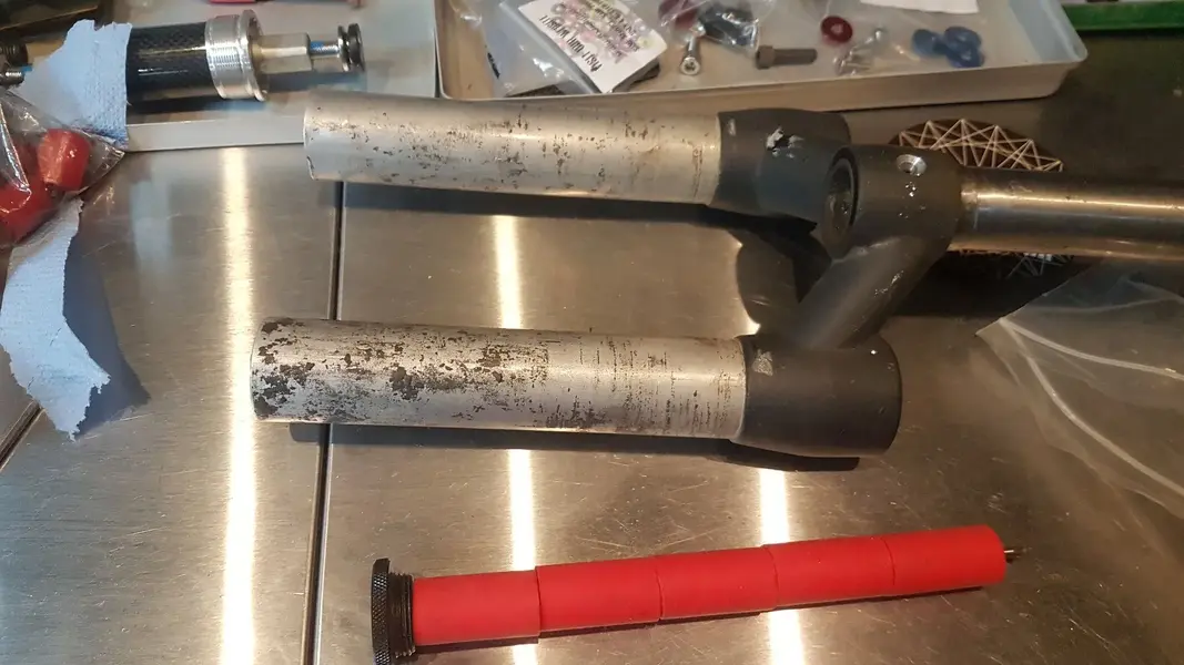

Always fancied a pair as they really caught my eye back in the 90's but they don't often come up in the UK. Back in December a pair were offered for free on Facebook as they were in quite a state. Tim was based in Canada so postage was going to be steep, but as they were gratis I thought it would be rude not too try and rescue them. Tim posted them at the end of December and they took 4 months to arrive😱 But escaped customs duty so the postage looked to be worth it. So this is how they arrived.
Siezed solid and looking a bit sorry for themselves but I was looking forward to stripping them to see how they were constructed.
Mmmm just as bad as Manitou elastomers 🙄

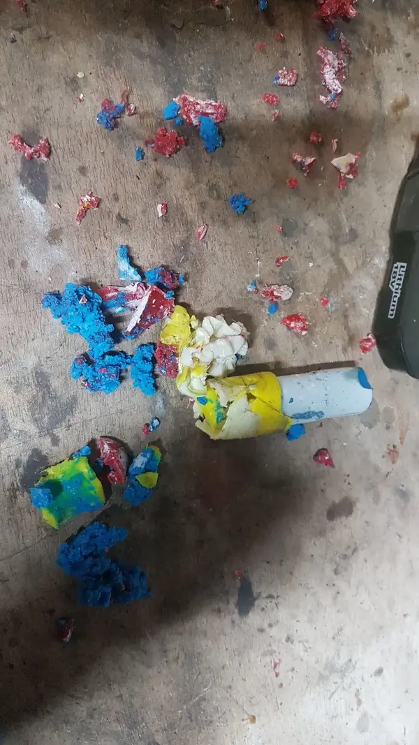

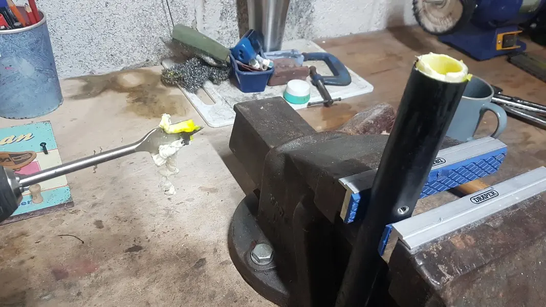

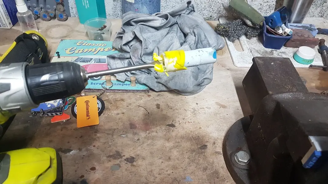

Elastomer goo, the stickiness substance known to man🤨

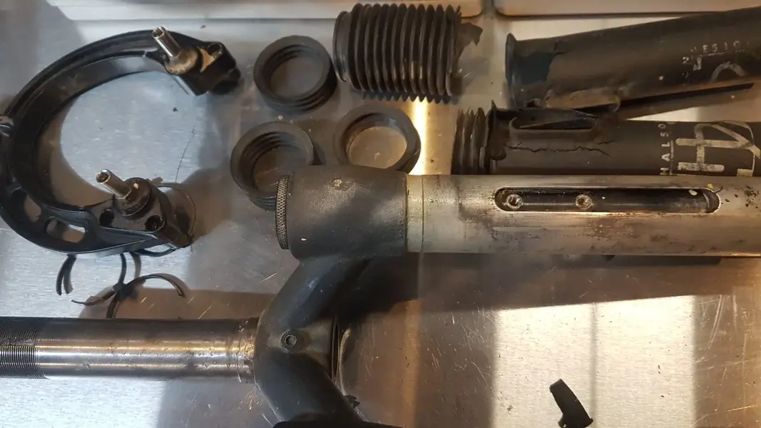

New silicone springs from...."Silicone Springs" of this parish. Bottom elastomer was narrowed with a bench grinder.

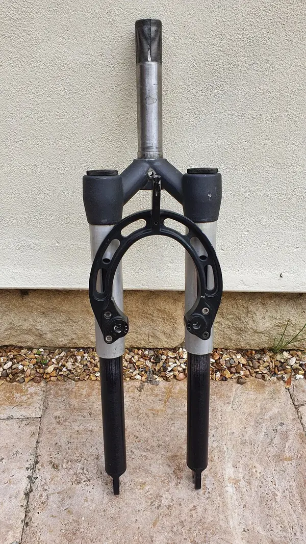

Now bouncing nicely😄 So now I need to work out how to recreate the dust seals....not going to be an easy job🤔
And needs some cosmetic work,.May change the steerer depending on the frame it's going onto.
