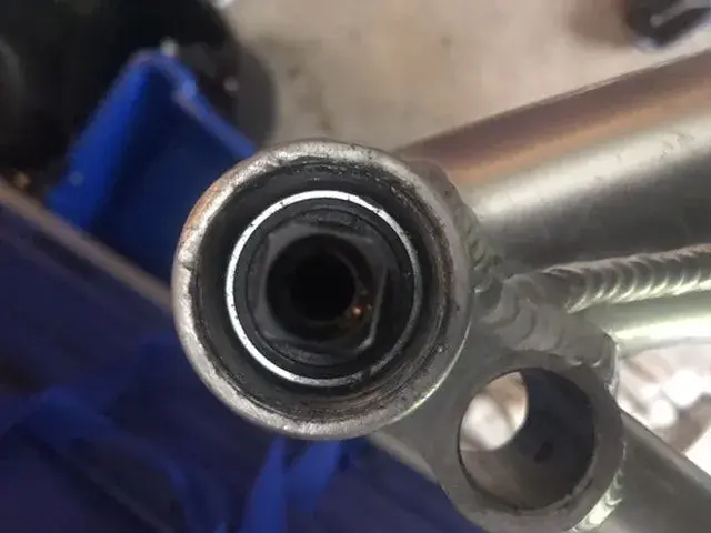

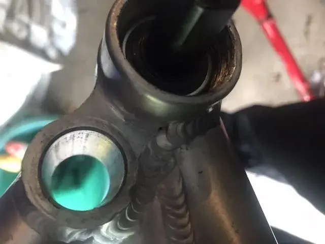

Got some pictures of the damaged threads?
Here you go, not the best so I’m not sure you can see the damage properly.
