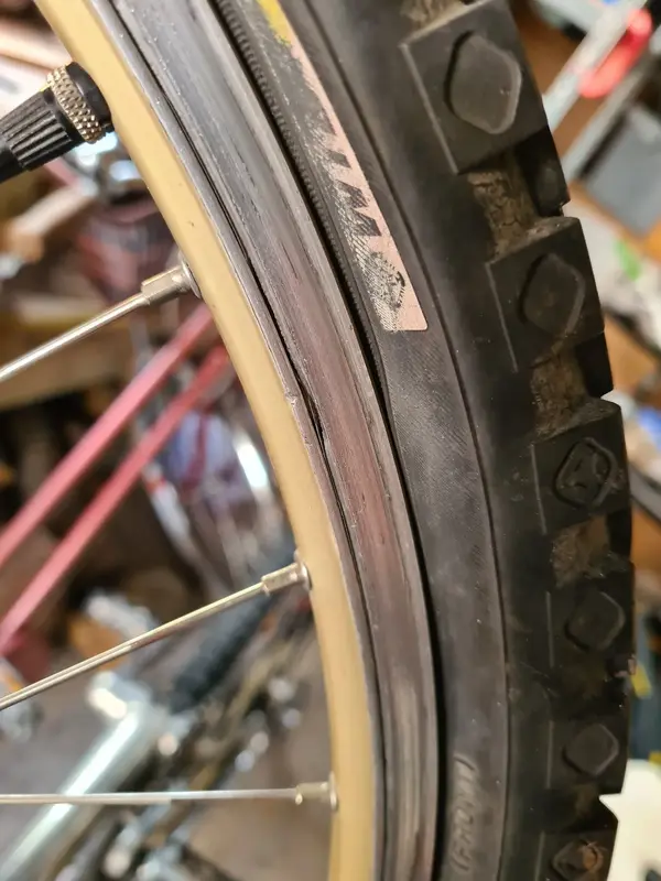

I thought the gold Mavic 221 rims would be fine, but the front has some serious wear and will need replacing
