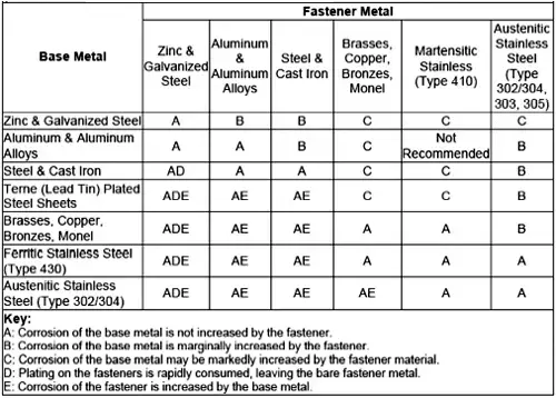

It's been raised before on here,and will probably be different opinions/experiences but copper grease has more limited applications than people realise.It will react with certain metals (although this can take time).Definitely a no-no with aluminium,accelerates corrosion.Non metallic greases best,or as I've recently discovered courtesy of another member,nickel based grease.
I know copper grease on the back of alloys to stop them binding to the ferrous hubs works & pretty much well recommended.
I did this for many years,didn't see an issue.But,if you leave it long enough,once the carrier grease has dissipated the copper left behind will corrode any bare aluminium it is in contact with.If the wheels come off regularly enough and fresh grease applied you wouldn't see an issue.But if left for too long it will increase galvanic corrosion of the aluminium.
A big no-no in marine terms is dropping a copper coin in the bilge of an aluminium boat.Corrosion soon starts,increased by any salt water.If you google 'copper grease with aluminium' or similar there's a wealth of info from reputable sources.
High temp applications on steel are ok,it doesn't react as much but for aluminium or non-high temp use,non metallic grease or nickel based as mentioned should be used.Ceramic greases are now also available to counter this issue.Also aluminium greases but apparently some contain copper.
I don't remember what I used on the seatpost of the one aluminium build I've done so far - check on the do-list.
Before I knew all this I once fitted a pair of M950 calipers using a good coating of copper grease.Used the bike for a short while,summer use mainly,all good.Left for a year or so and came back to seized calipers.White oxidation present,was astounded,never had that happen with lithium/synthetic grease.
Took me a long time to accept it as was a huge copper grease fan.
