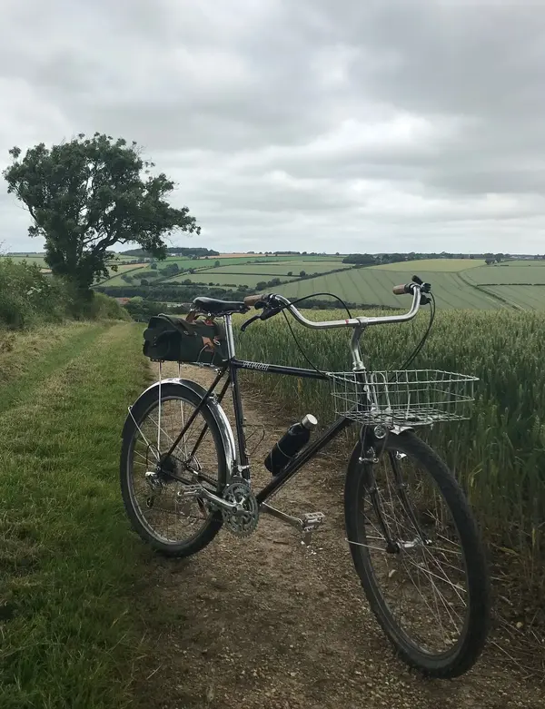

So, can I have my cake and eat it? I want a nice shifting full range freewheel for a 130mm 80s MTB.
I’ve been (manfully) running my Specialized on a 6 speed freewheel with suntour thumbies. It’s my do it all bike (definitely not a gravel bike though....), has a 130mm rear end and a nice set of RM20s laced to XC Hubs.
I’d like to keep the wheels but have to admit to having a hankering for, er, slicker shifting. My baseline for slick shifting is XT 9 speed with dura ace or microshift shifters.
