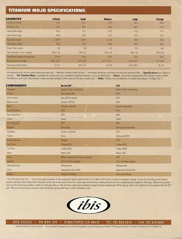

I thought I would do a renovation post for this lovely Ibis Mojo I’ve picked up recently. I’ve started assembling the parts for it, but just to warn you all, it’ll have new gen tyres and grips, as with most of my builds, I go for looks and comfort over complete originality.
Groupset, saddle and forks (both pairs) are all available if interested!
Found the spec sheet, and amazed by what it says "We'll use the Amencan goodies made by small guys like us. We will also make every effort to keep Shimano components off this groupset."

There is nothing wrong w/ this build. I would lower the stem and ride it non stop. It´s easy to upgrade the drivetrain but finding a fork on par w/ the frame is going to be hard.
Thanks for the comment. I don’t think the XT groupset is right for this bike. Wheels, bars, stem, seatpost all stay but all the blue goes too.
