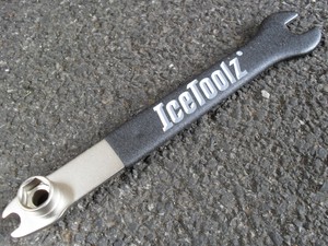

My big problem now is that I haven't got a tool that will fit the crank bolts. They look to have a 16 or 17mm head and my 17mm socket won't fit inside the crank. Then I've got the problem of finding a reasonably priced 23.35mm Stronglight remover! Anyone fairly local to West Yorkshire got one I can borrow?
Given the frequency at which I needed to use the tool, I spent a whole £11.something on a set of box spanners from Machine Mart. They're crude but the metal is solid enough & did the job. An inexpensive way of solving the problem. https://www.machinemart.co.uk/shop/prod ... set-metric don't ask me why they are £21 on the website, they were £11ish two weeks ago in my local store.
