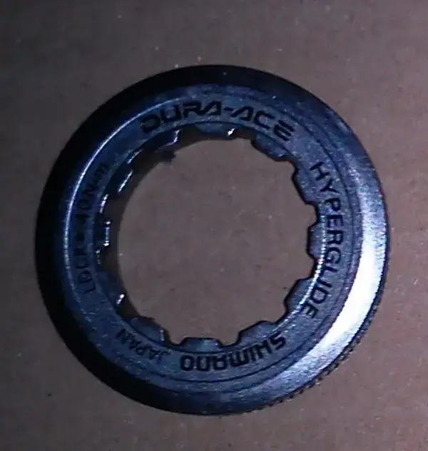

Other that that is what my friend bought it as and the fact it says Dura-Ace on the lock-ring and that it is a somewhat unusual design nothing really :(
OK, seems fair but sadly the lockring text isn't clear from the pics and I wasn't there when your friend bought it so surely I can be forgiven for thinking this looks surprisingly similar to any other Hyperglide block <smile/LOL etc>
Sorry I may have come over a bit harsh, but the truth is in my estimation there is really nothing that sets this apart, except the facts I gave you I am beginning to wonder if he was sold a pup :shock: :( :oops:
FWIW, my 7401 8 speed dura ace 13-23 cassette weighs 302g, complete with all spacers and lockring. The sprockets are a different colour and texture to other shimano cassettes - kind of a matt "champagne" colour and not the shiny chrome of all the other cassettes I've seen. All spacers are alloy.
