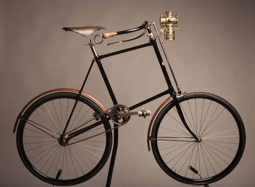

Has everyone seen the giraffe bike Paul Brodie built?
https://www.brodiebicycles.com/brodie-b ... -cycleexif
Yes, absolutely wonderful, I wish you could buy bikes like this. So much more interesting than modern bikes. It would be a great bike to take around the local trail centre. Imagine just how far you could hang off the back on the 'drop-offs'. :cool: It also has a suspension seat-post and a front brake that also clears mud from the tyre. :shock:

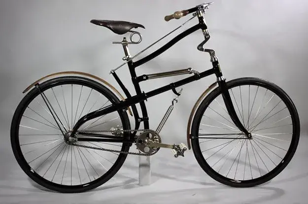

What could this bike become if it were re engineered from today's marerials?
This bike uses a Watt's straight line linkage connected to a single spring in tension to suspend the rider above the wheels. The advantage of this is that there will be no front end dive when braking and no rear end squat when accelerating. If fitted with a pre-loaded spring, the suspension could be completely isolated from the transmission forces.
