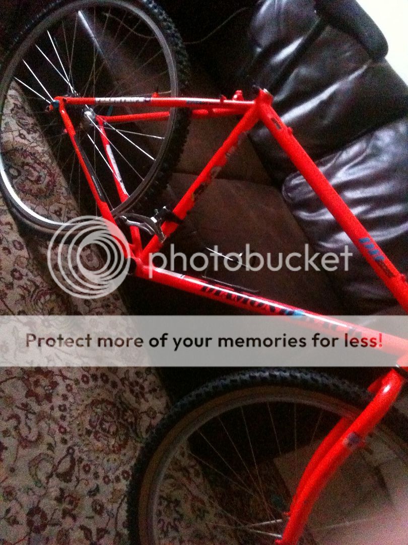

Currently the frame has undergone a full degrease, clean , paint renovation and full on waxing so at least she's finally looking good , just need to finish my beer off then its time to start browsing for those missing parts.
For now then here is where I'm at.
Steve

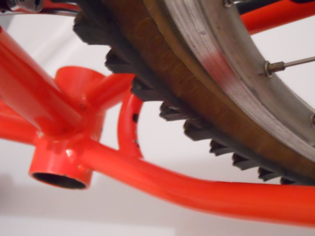

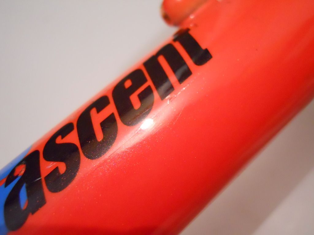

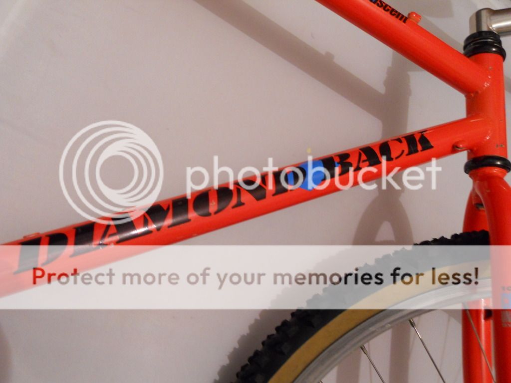

Thanks Unit3, honestly if you'd seen it when I originally pulled it out , you would not think it was the same frame :shock: , although many hours of cleaning and car polishing products seem to have paid off, something that i was concerned with was any issues with rust, but it appears that it may have escaped the demons :)
A full bike shot is not something I've really done since I finished the cleaning, but here's a phone one during the beer stops yesterday.
Lovely! A nice blank canvas to start with.
Looks really clean and in good condition. Love the mint sauce stickers :) .

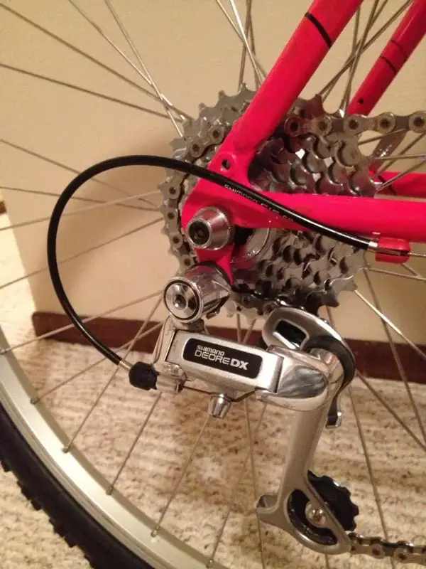

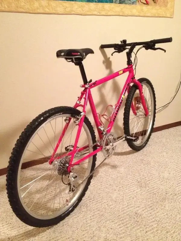

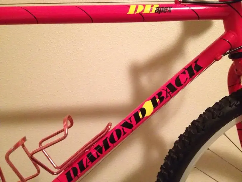

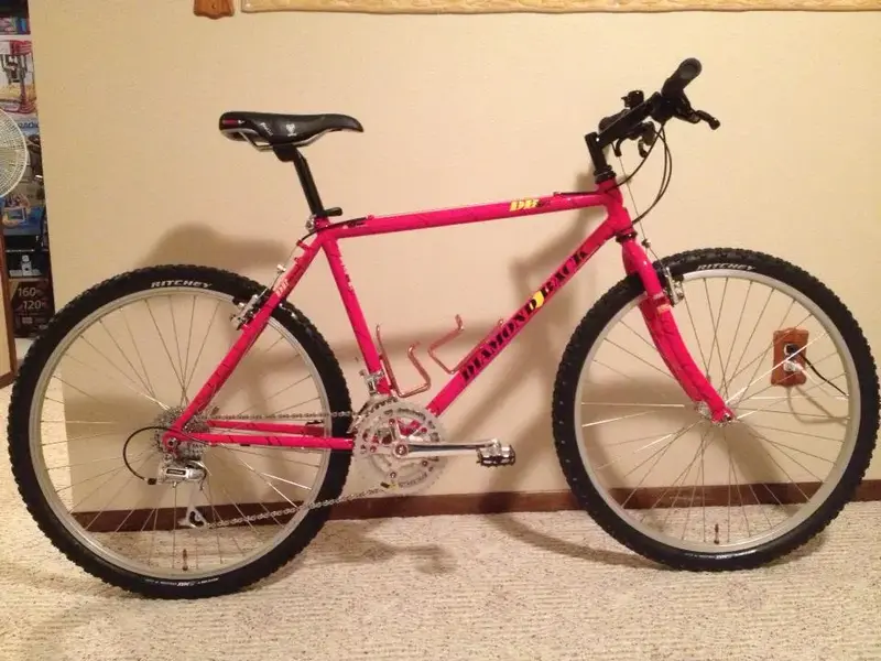

Very nice. Just like you said, it's no Klein or "high end" maker, but I've always had a soft spot for Diamondbacks since picking up my '92 Axis more than 20 years ago. Just this past year, I scored a pretty good condition '91 Apex off Craigslist for $40. Stripped it down, restored the frame with touch-up paint/wax, polished up all the parts, & replaced a few things. Built it back up & it turned out pretty nice for a bike for my son.

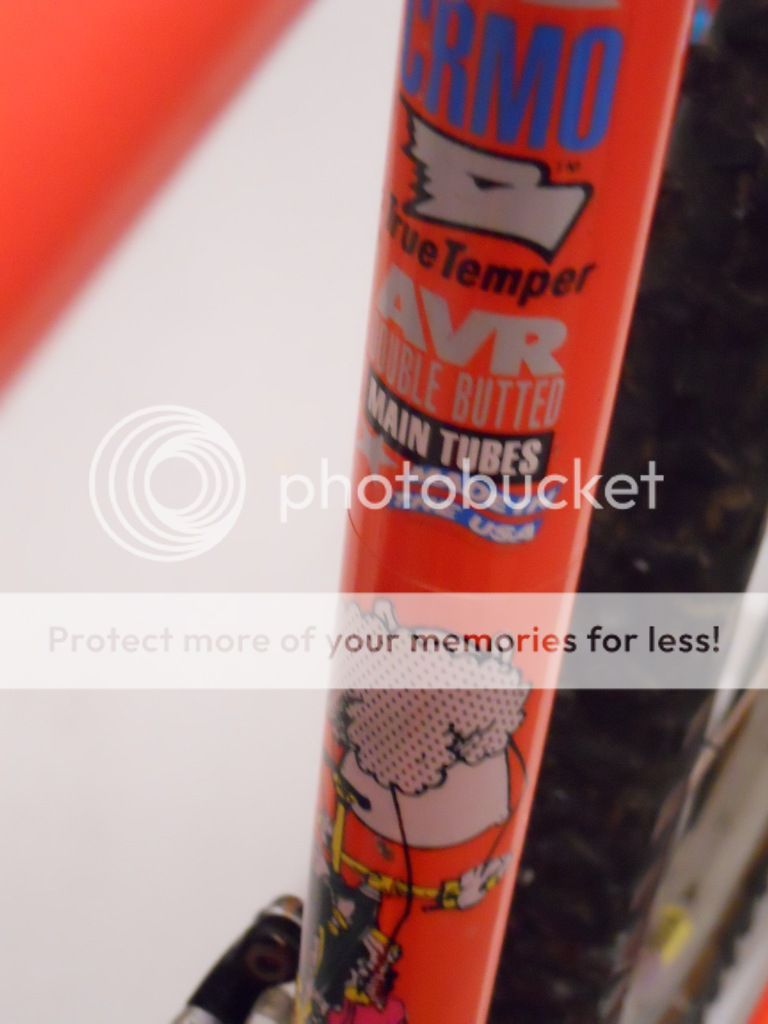

I'm really loving the luminous pink colour of your Diamond Back Apex , very retro and cool :) and certainly for the price you paid makes it even nicer, you've a really nice selection of parts adorning it too from what I can see, In my eyes a very nice build and if mine is anywhere near looking like that I'll be a very happy bunny for sure :)

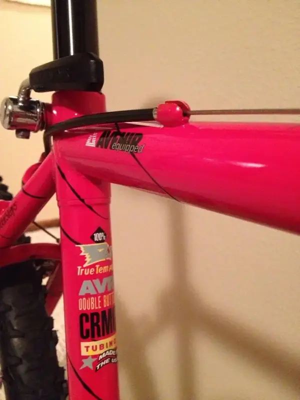

Would you mind if I enquire as to the diameter/size of the seatpost you are using please ?
I ask as your Axis is a 91 model, same as my Ascent, and I'd assume, and I could be wrong that the seatpost frame tubes on these two models from the same year would/may be the same diameter., obviously correct me if I'm mistaken in making this assumption :)

Thanks for the nice comments. It's actually a deep red, but looks a bit pink in the crappy IPhone pics, which is okay, as it makes it look a little more 90's-ish :) Anyway, the seatpost diameter is 26.2, which should be the same as yours, as the Apex has the same True Temper AVR tubing that yours has. My daughter's '91 Axis Team has a 30.4 seatpost, but has True Temper OX II Ultra tubing, so should be a mute point. As for the paint, I just went to a hobby shop & got some little bottles of model paint with colors as close as I could get it. The red I got was a little darker & browner looking than the frame, but it blended in okay & looks a thousand times better than all the chips the frame had, especially with the white primer underneath showing on most of the dings. I also re-did most of the decals (black lettering & yellow highlights) with the paint, and with a very steady hand, turned out a lot better than before :)
