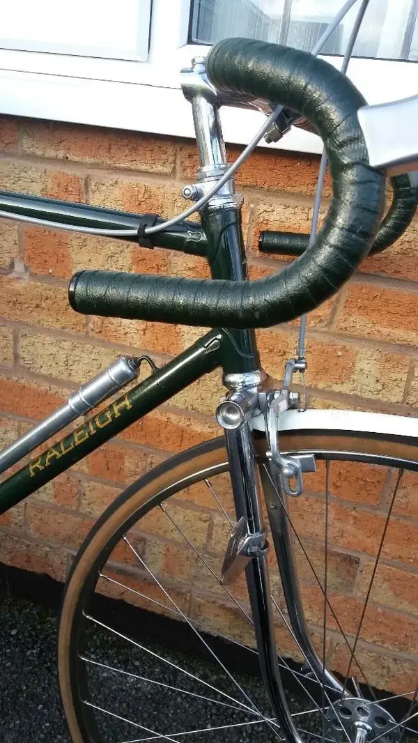

Hi, this is the only one I've used shellac on, I wrapped once from the top down then gave it 3 coats of shellac to darken the tape to match the frame. The tape itself was lime green to start with. Shellac has a short shelf life once opened so ideally you need to get all your coats done within a few hours. If the shelf life expires it will never properly dry and stays sticky. I don't think I'll use it again.
That looks lovely. Why won't you do it again?
Mainly because of the cost and that over half of the bottle goes to waste if you only have one bike to do within the max 6 months shelf life.
I might try several coats of thinned polyurethane varnish if I have a similar job to do.
I also use shellac. I use the dry flakes and mix when I am ready to apply. Sometimes I use clear so as to not change the colour, sometimes the amber, sometimes I mix the two.

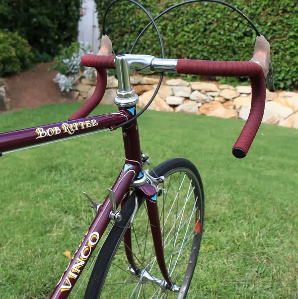

On Bob's Vinco, I wanted to darken the colour of the tape, but have the finish clean so as not to disturb the former owner's disdain of shellac.
It passed the test.
The build thread on Bob's Vinco
