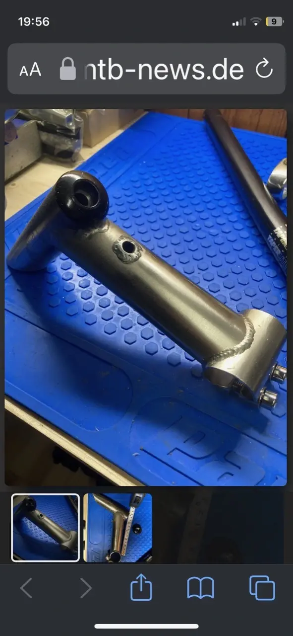

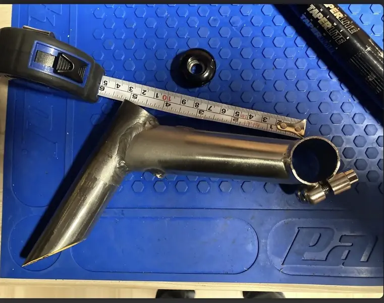

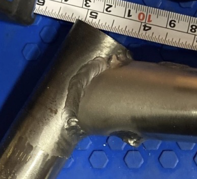

Hi can anyone help to identity this stem?
Seller say it’s a cook Bros in 1 1/4 can anyone say something about it?
It’s steel an originaly the stem was yellow with Blue Cook Bros Decals

That’s some quality welding. Cant imagine that is anything to do with Cooks, its an abortion of a bike part

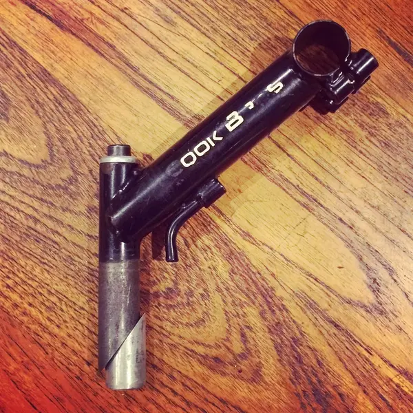

FAKE! CBR never made 1 1/4" fork anything! They did make a few of the "VGS" series stems in 1 1/8" though.
Hi Jack, can you comment on the CB marked steel stem I posted above? I can´t find any reference to this style of stem being an original.
