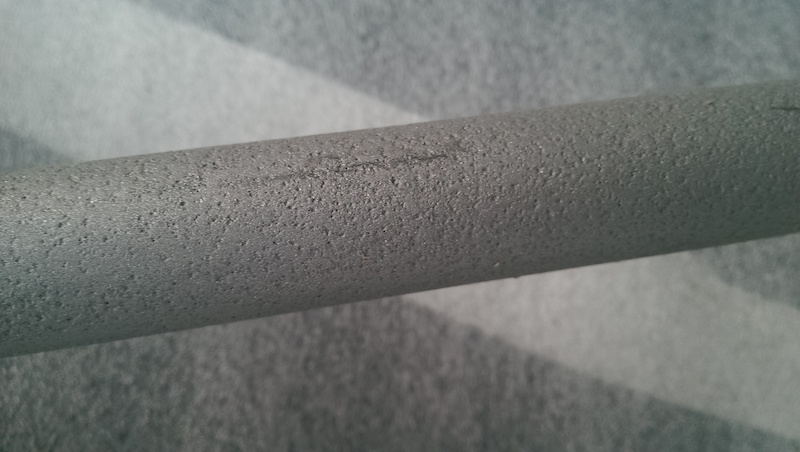

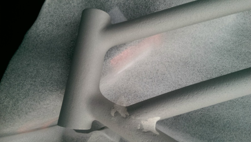

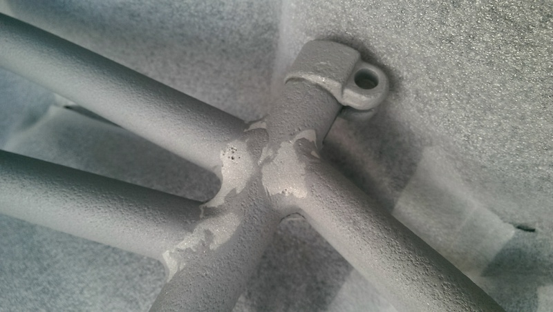

So finally I had the frame blasted, as you can see there are some different types of filling used.
Some brazing on the chainstays, some metal putty on other plces to simulate brazing and on the headtube the files the weldins I suppose?
The frame is in a little worse condition than I thought, not rusted through so still a good basis, but it needs some work.
First thing I did was coating it with epoxy primer, so the rust doesn't get a chance.
Next is coating the inside and then I have to decide if I do the painting myslef or go to a proffesional.
Little progress but we are getting there, when the painting is done it's just building up, all parts are there :cool:

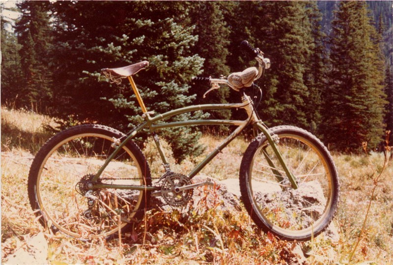

Re: Schwinn DX '40 Clunker [need help page 5]
Some did have canti's in the back, this is Alans bike in '79:
But it looks like a post war frame with original canti bosses.
So the question is, would they have adapted pre war frames to canti's?
I kind of like the BMX forks, but to find an period correct one with canti bosses is pretty hard to find.
So I went back and looked at all the bikes on Alan's site as well as Charlie kelly's site - and the only clunker that I've seen with canti's in back is Alan's personal bike.
All the rest (that I've seen) either use coasters or drums.
yes, there are bikes on Alans site with canti's in back - but those are all modern interpretations of clunkers. If you look at joe's, gary's, otis' bike,etc - none had canti's in back.
