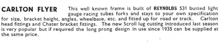

Hi, lovely old carlton, I've never seen that seat lug before, I would guess at 1952/3, they were just making changes to the range and up too 1953/4 they were still using Chater Lea fittings for the Road track according to the catalogues that is, but I would throw into the hat, the possibility its a Flyer, below there is mention of cut lugs in a 1953 cat, just a thought, worth checking. Love to see it when its done. Terry
