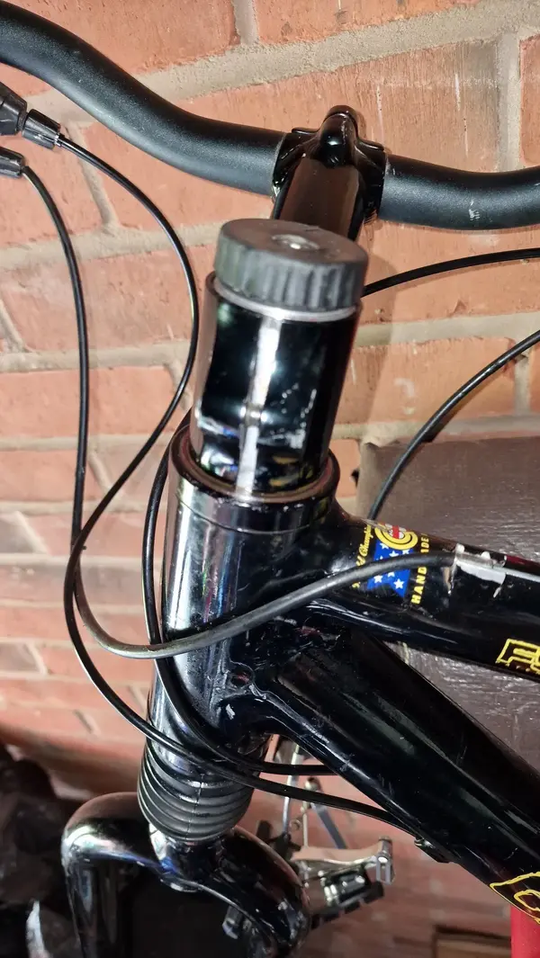

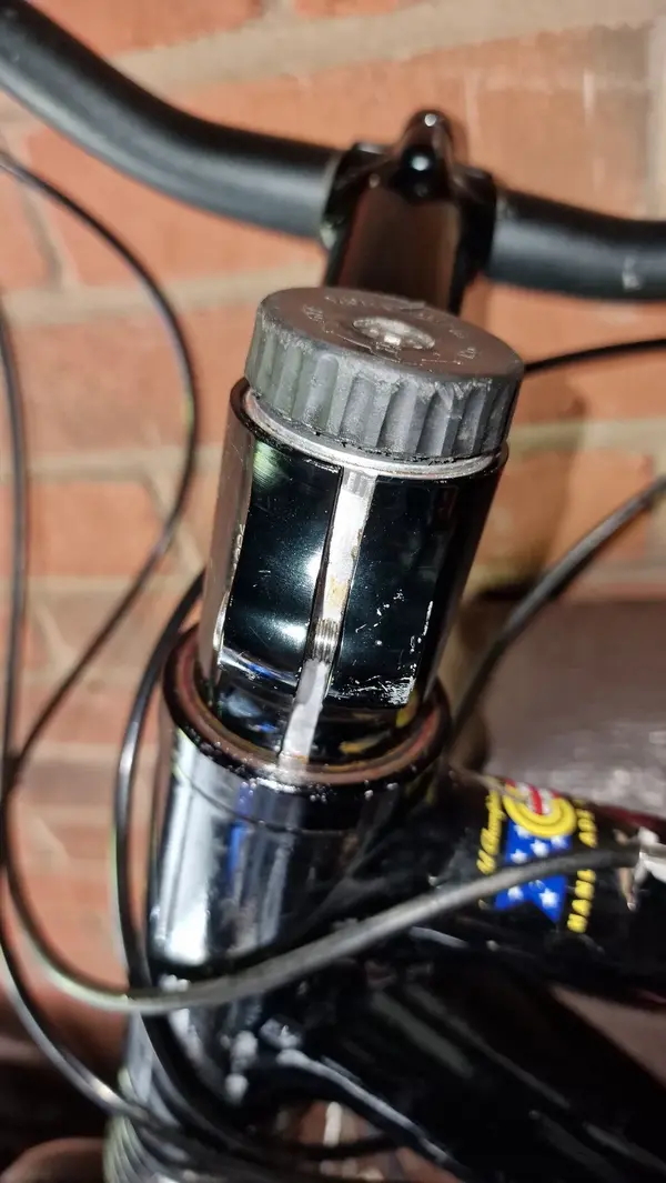

Hi guys,
Grabbed a cheap F900 off marketplace last night night,
instantly noticed the head bearing were a touch rough... My question is how do you apply preload to them like a conventional 1"1/8 headset? Does its just rely on on the bearings being a snug fit?
Also is there a top cap missing or a dust cap of some kind? As you can see the top head bearings 20220603_134647.jpg 20220603_105208.jpg
Any helps greatly appreciated
There is no preloading as the bearings are press fit and the forks then go in, you just need to get new bearings.
You can also get a dust seal to go between the stem and the top bearing, although, from memory, I don’t think the early ones came with one…No harm in adding one though.
Thanks for the reply bud, Yeah had some help off a couple of Facebook groups and managed to order the bearings and a top dust cover :) just waiting for the postman now then I can get out on the retro beast
