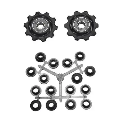

Don't know too much about Campag from this era. At least on the Shimano side, I've solved this with third party jockey wheels that come with a variety of spacers. Of course it's nice having a jam jar of various bolt lengths too. Agree, there is a bit of "sucking and seeing" with drive train modifications, but usually there is also a bit of latitude.
Yes, those Tacx jockeys (and the BBB ones that are very similar) could be a bit of a life-saver :-D
