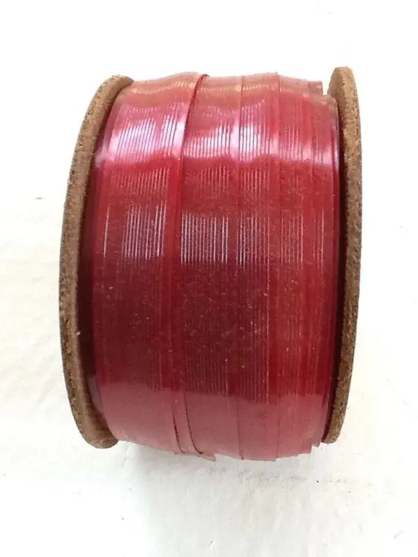

Right, I've got bored of tripping up over this so work has picked up again. Tyres and tubes, and cables and bearings being sourced. I'm just looking into handlebar tape now.
Is this red plasticy stuff original you think? And what's it actually called, if anything?
Hoping to get this up and running for a few Hampshire Lightweight section rides with the VCC this year.
