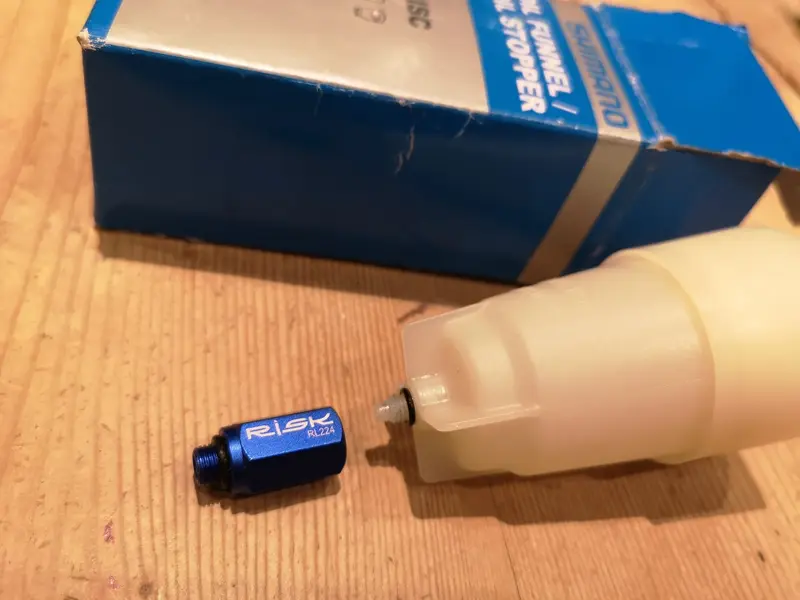

Why do Shimano make the thread for the bleed pot different sizes? I have an Mtb one and bought a little chinese problem solver adapter thing for a couple of quid. It's anodised blue so looks like Park Tools from a distance.

A quick warning to anyone with Mtb and road discs, as I mentioned above somewhere, Shimano make the master cylinder bleed port and therefore the bleed pot thread in a larger size for road levers. Just before you cut your lines on a Saturday for a Sunday ride check your tools to hand. I got this little adapter off ebay, cheaper than buying 2 nearly identical bleed pots. IMG_20240315_190659.jpg
