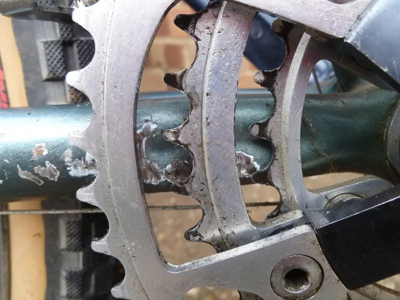

Curious to know if anyone has an opinion on weather Biopace rings encourage chain suck ?
I've only got them on one bike and it , er well , sucks .
I had a Biopace chainset (105) on a road bike for plenty of years with no noticeable issues and I don't recall it being mentioned as an issue when they were introduced back in the day. I suspect wear is more likely, as @DoctorRad suggests...
I've never heard people champion Biopace rings for anything in particular. Modern oval rings are supposedly better but I never understood the concept. I've heard people report chain suck issues with Biopace, but I think it is more likely a result of them being kitted on old bikes that's seen a lot of use and as a result are worn down. As suggested twice in the thread.

Not a fan either. I used to ride biopace bitd - usually on middle ring and sometimes at an extremely high cadence (once got up to 40mph downhill without spinning out). Biopace always caused knee pain, but near instantly went away with plain circular rings. Wouldn't risk them nowadays.
