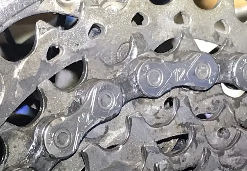

Bike chain
Thanks for your prompt response. I couldn’t read KMC but a quick search for KMC X12 brought up a picture that’s identical.

Might want a new cassette too, a bit of meat gone from those teeth I'm afraid and anything above 10 is known for eating teeth if the chain isn't replaced soon enough.

There is an argument that material changes have been made in newer cassettes but also the increase in details like ramps, where the material has been intentionally thinned may have something to do with it. The sprockets themselves are no thinner than 8 speed so it's something of a strange finding but gone are the days of 3 chains to a cassette, I'm lucky to get 2 chains on the 10 speed and I have to constantly monitor wear to not let it go over .75mm stretch.
Maybe I should just run with the original chain and cassette a little longer and book it in for a service in the autumn to get both changed as I’m not too comfortable changing the cassette myself.
