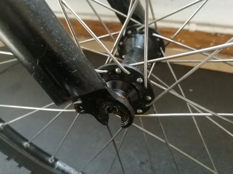

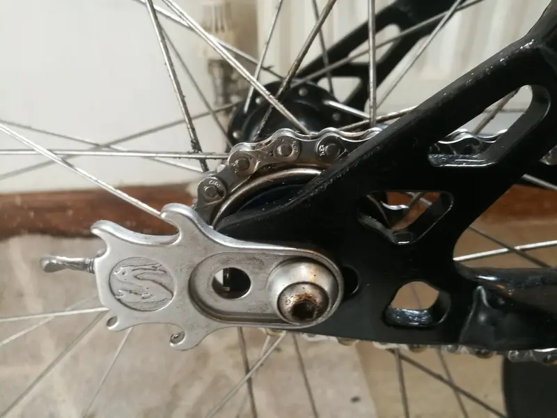

Hello,
Couldn't see a mechanics section.

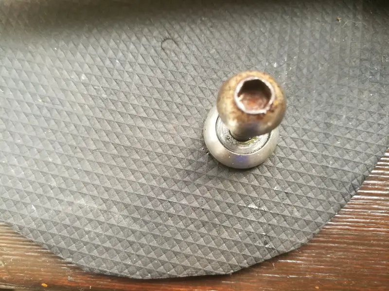

I need new axel nuts M6 including the serated cups that fit onto the frame.
Can only find bmx titanium bolts that seam to be the wrong size & not serated.
Might not be essential the cups are serated, i ask here as assume someone may know a supplier preferable that doesn't charge £10 a bolt like many seam to be asking.
Ill update better pics of current bolts tomorrow.
The last parts of my project priory it complete as the current ones are rusted & loose when tightening etc.
Thanks

I'd just try halfords, or any local bike shop. I'd doubt they are m6 though, standard axle sizes are 9mm front and 10mm rear.

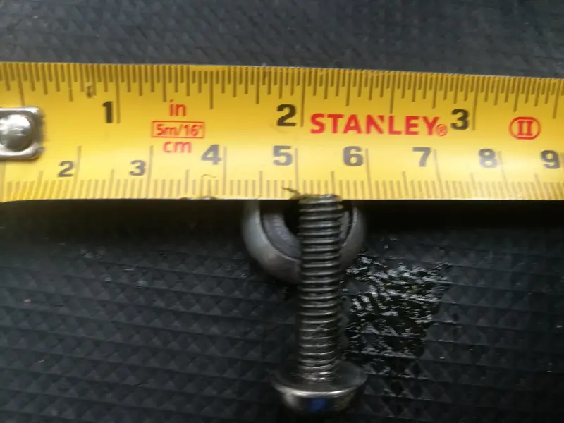

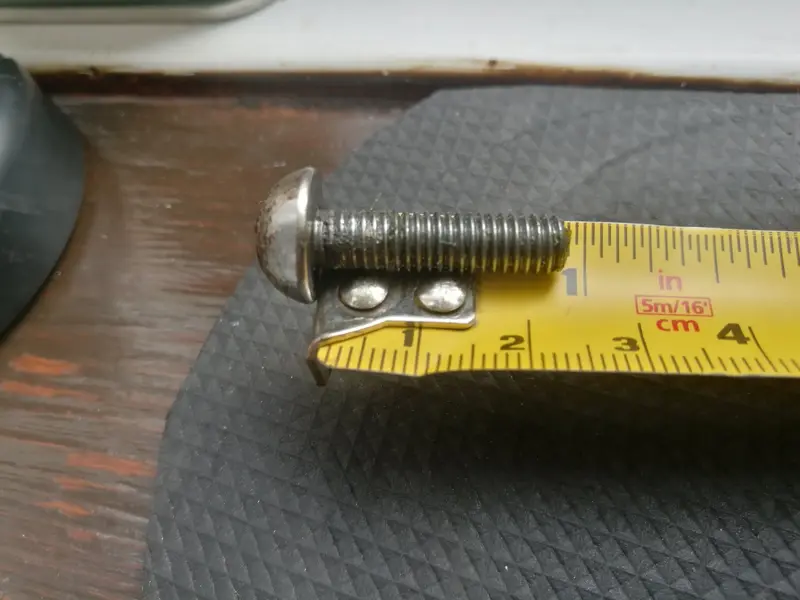

Hello,
Pics & afaik their M6 with actual thread 23 mm long could use 25 mm etc

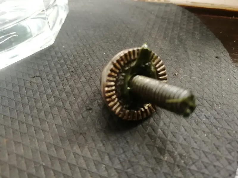

I've looked for them & the cups are fused on two or three of them or i would of just got some bolts but also the mushroom size of the head fits better than my spare M6 bolts inc flange ones.

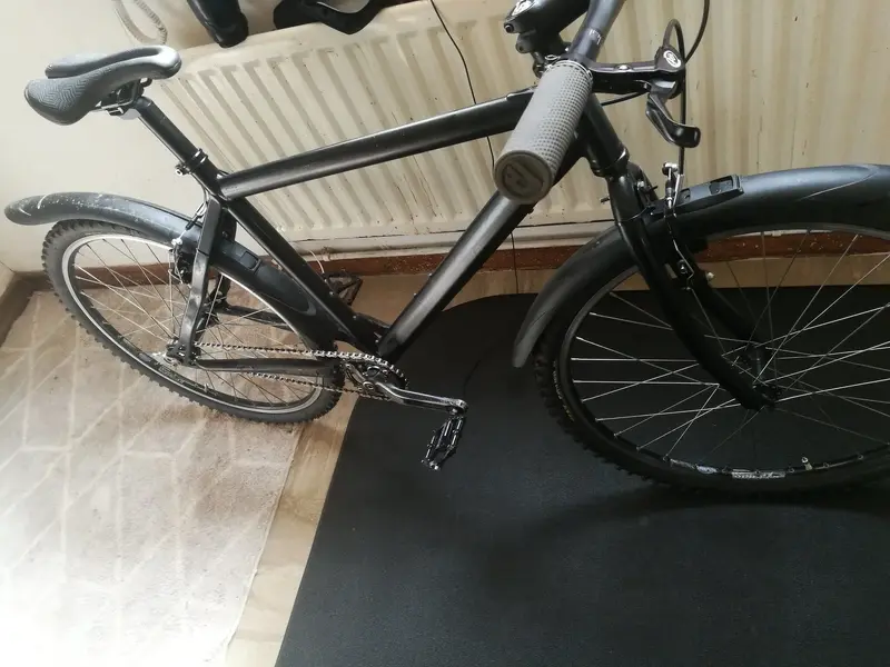

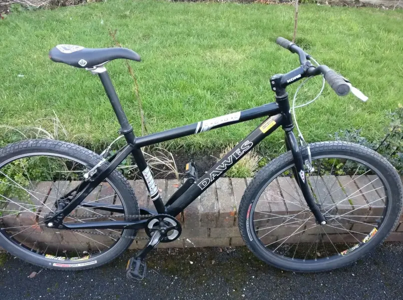

Only these parts to source as intend on keeping bike as great little machine that's cost £300 now but i like customized bikes !
New bolts stem headset crank BB chain guards tyres seat & clamp bars seat post pedals & has a white industries freehub ! which was a bonus as bike only cost £60 originally.
& i prefer poor anti theft diy paint job !
Ta

The bolt looks like a standard m6 button head. They do a flanged version too....10p a pop from any fixings place. Just keep your ribbed washers.....
Im more concerned you say they won't tighten....those bolt threads look fine to me....i would be more worried the spindle is stripped inside.....
Ah didn't realise the axles were threaded internally to take bolts, thought they would be standard axles with external nuts to secure them - a picture tells 1000 words. Agree with Tootyred though - bolts look okay, could clean up with some wire wool but the threads look fine. What's actually slipping - are the hex heads rounded (don't look to be?)
Right, there's no current slipping & as said the serated cups are fused on three of four, I've used new button double washers stainless steel & bolts previously but despite mild use i wasn't happy with integrity & reverted temporary back to the rusted ones.
Having read titanium penny washers reportedly three times stronger est they should do the trick matched with button head titanium bolts as only a tenner & keeping bike.
Priory purchasing my only concern is the rear dropouts without the serated, thus having given weight & intended use im not mechanically minded & was hoping someone might say the following:
With that weight & uses gravel type affairs they should be fine / hold up but including don't take my word for it, its just
experienced opinions would align to my thoughts it will be fine.

Thanks for replies if anyone can say fairly tight should be fine with suggested Titanium that will do OR if you know any 20 mm serated washers to taly with the titanium that aren't super flimsy as i haven't gound any that are about 1 mm thick & 20 mm wide.
Incidentally im using 2 washers per side 8 in total as previously that improved the setup but still was a little flimsy.
Thanks
You shouldn't need to be doing them up tight enough to bend normal washers, let alone needing ti....
If you think that many qr set ups are alluminium which bolt tighten on (security skewers etc) they really dont need much force with an allen key to hold a wheel in!
The clamp force will many times surpass any anti slip force added by the washers being grooved.
But you could try adding a locking washer if your really worried...look up serrated washers or nord lock or anti vibration washers....
That's what i was after hearing one other person confirms your thoughts & ill order.
