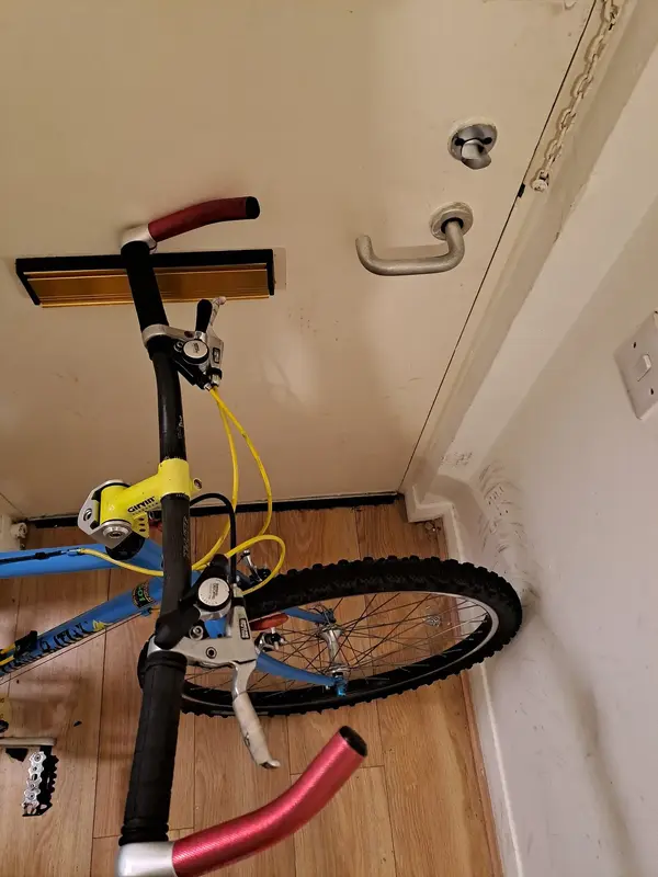

Are carbon fibre bars able to be cut down at the ends ????
Shaggy1979
Gary Fisher Fan

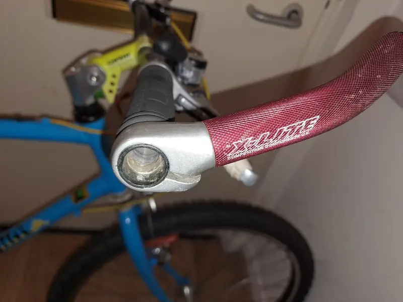

There is an inch at each end before it reaches the internal sleeve does anyone know if this is bad for the bars being exotic material I'm not keen on the length of them for darting through traffic ...

Will be better cutying them down as the bar ends will be clamping on the thicker bar.
