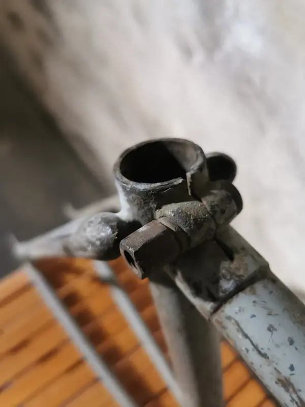

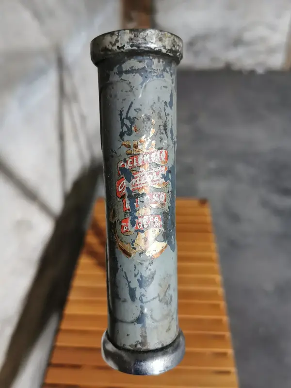

Any Idea? Ancora Milano frame from the 20s/30s

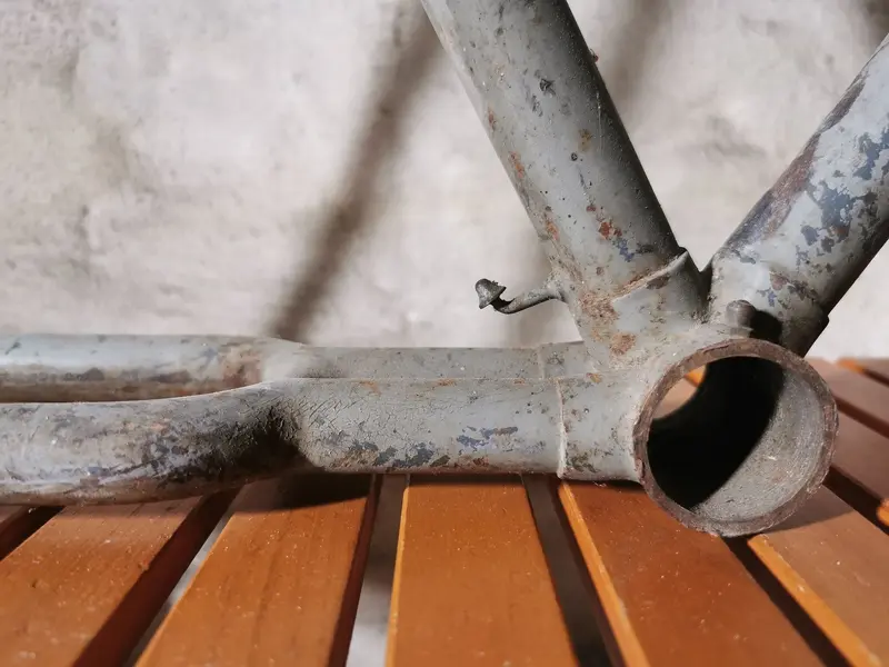

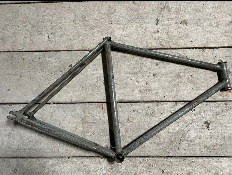

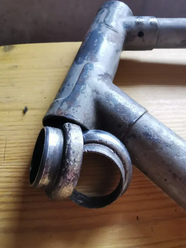

Yes, I aggree. Need to find some cups for testing over here - but its funny, having an Italian frame with French/Swiss threading.
I am still not certain how to build it, also having a rather standard headset and hence a lot of forks to choose from makes it a bit easier...
Can't see another way except trial and error - I wouldn't pay too much attention to the shell width to be honest.
Back then I suspect things were not as clear cut as St Sheldon would have us believe (he's writing that from an American perspective and a post war period). I think it was more of a blur between European bike builders.
Probably. I just learned that I meassured the BB the wrong way. Not inside the shell (35mm) but on the outside around: 36mm. Makes more sense of course... An ITA BB it will be.

Just received a test BB for the Ancora frame. It defo works while the shell could use a re-threading. I'll have this done at a vintage Italian race bike shop (cicli berlinetta) close by.
A matching fork might have appeared as well, neither an original Ancora nor from the period in question, but with a nice looking fork crown from an early GDR made Diamant touring bike.
Next thing to sort out will be the rear hub, either an classic track hub with 110mm, a new downspaced track hub or some sort of vintage internal gear/coaster brake hub. Anyone has a spare Sturmy Archer ASC ;)
Cheers
