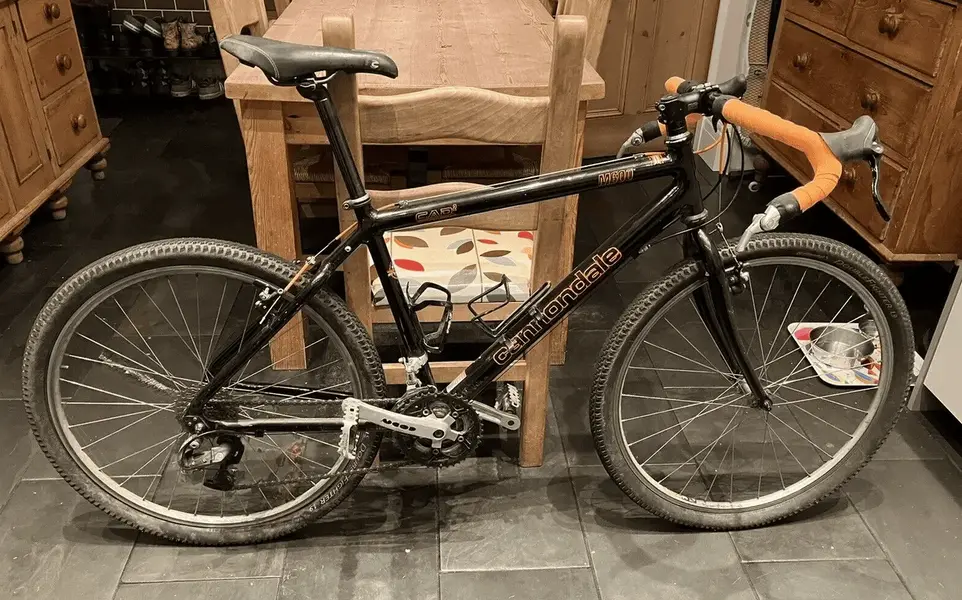

And a quirky Cannondale M600 Notts £60
Synthiaks
Sadly it’s designed for V-brakes only. You can run cantilevers with a cable hanger on the aheadset (there is room) or with different stem with cable routing. Or use the Cannondale Force 40 system which uses a rocker that the cable runs up to. However only the forks have a central mounting hole for this as the wishbone rear stay has nothing. Guess it could be drilled out if you really wanted cantilevers vs. V’s...
Currently you don’t have brakes! 🤣🤣🤣
Easily done with one of the many seat post collars with inbuilt hangers on the market
