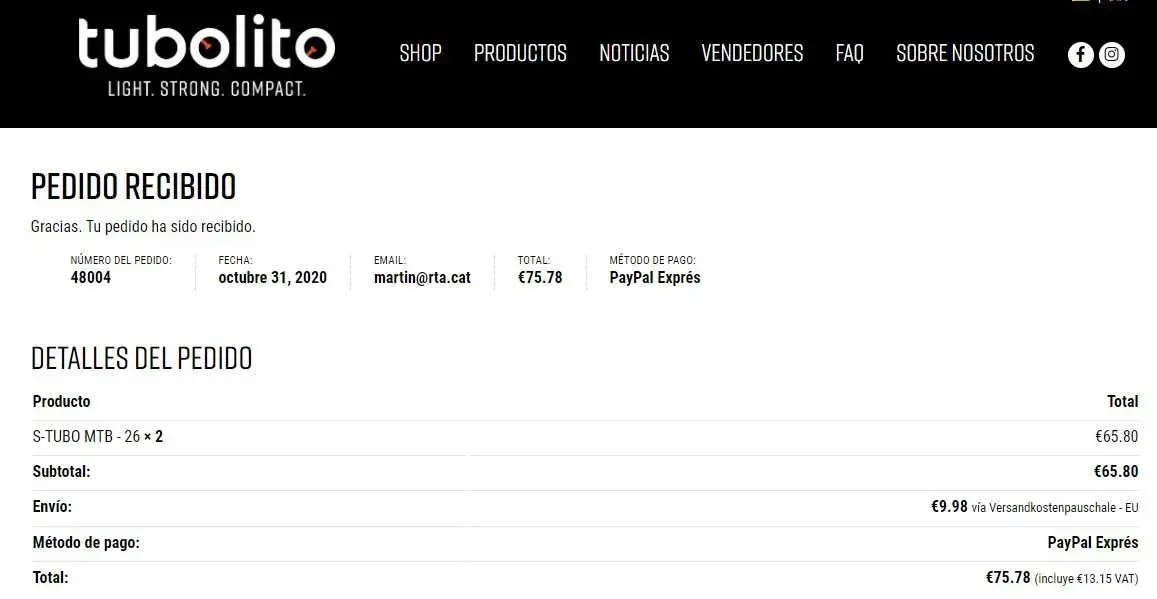

ordered !! yes I hope to save close to 100gr !! good appointment
There are some other options for lightweight inner tubes tha weighs the same but cost less:
But the tubolito inner tubes has some advantages; maintain the preasure quite well. I like them.
