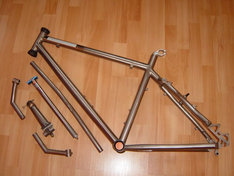

Not a lot of movement on my build, but I have finally got my stickers to do the frame blasting - well happy with the text font and sizing etc :cool: I was hoping to get it blasted between Christmas and new year but the place is family run (and closed) so it will have to get done in January some time :D

Quick update as I am getting the frame refinished tomorrow :D

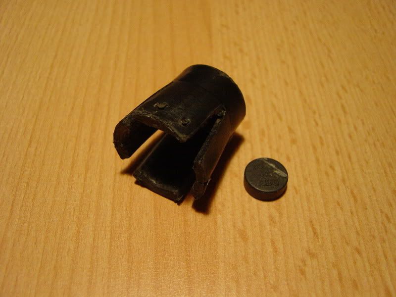

The offending Datatag :
I saved a massive 6.8g’s by removing it … :oops: :LOL:

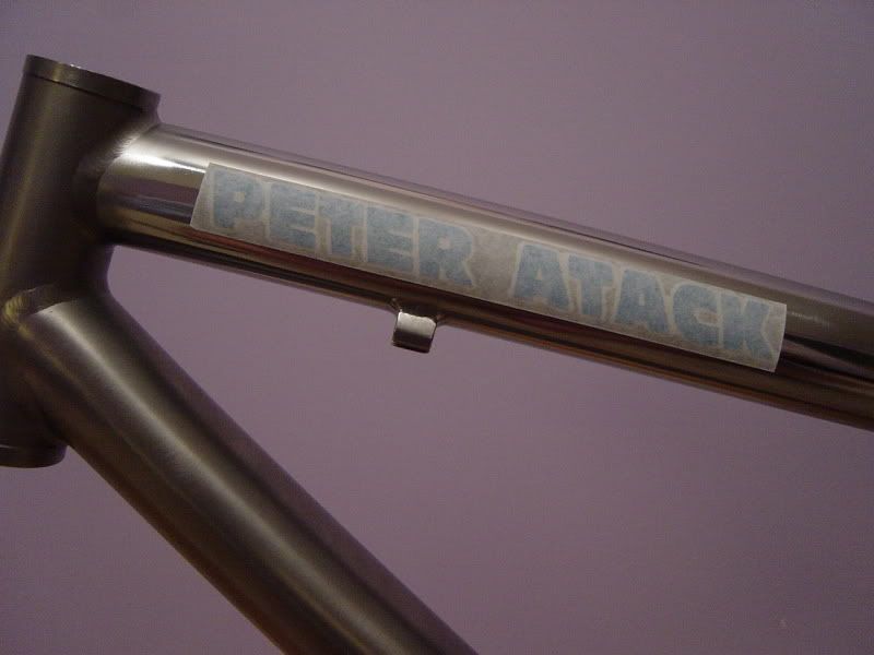

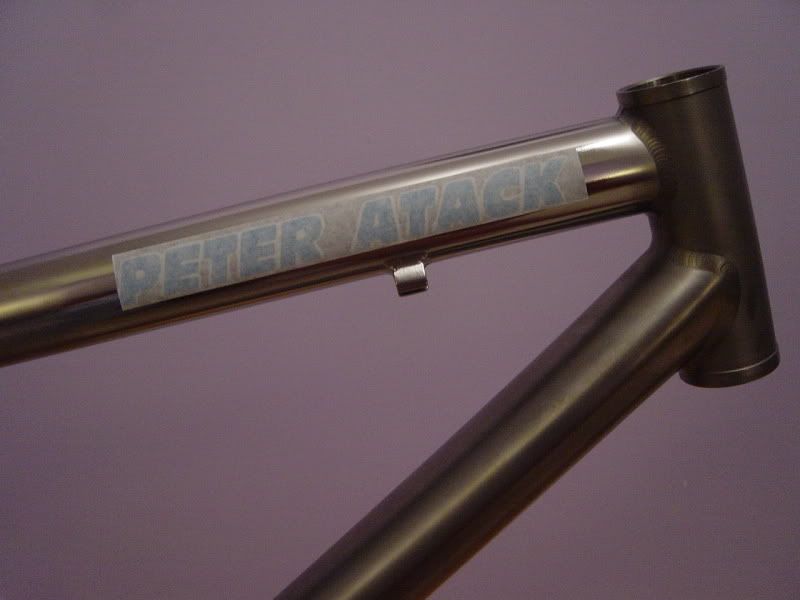

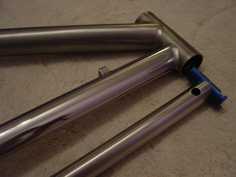

I wasn’t quite happy with the polished areas on the frame and seat post so I had another go to get them to a standard I was happy with. They are now much better :
Note that I only concentrated on the areas that will be masked so beyond these, the finish goes progressively back to standard :D
For anyone interested, Meguiar’s NXT metal polish leaves a slightly nicer finish on polished Ti than Autosol. Autosol however will remove fine scratches a little quicker. Perfect combo = Autosol followed by NXT :cool:

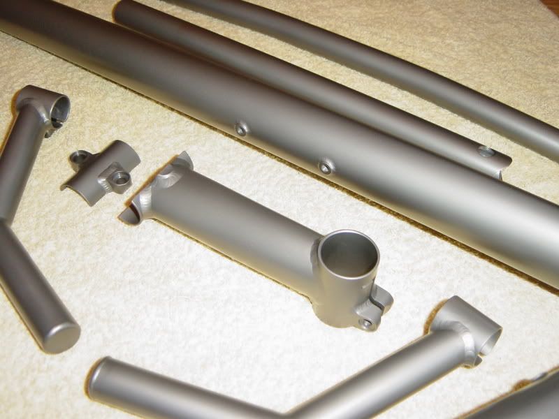

For info, so the finish matches the frame, post, stem, bars and bar ends will all get done at the same time :D

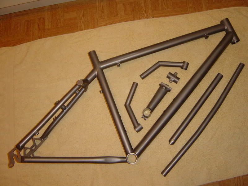

Progress at last pheeewwwww :LOL: :LOL:
I like the blasting method that you use to show the decals.....no one will be able to knick your bike now :cool:
They will :-( because they fell off :LOL:
Seems that the harshness of the full size industrial blasting booth was a little to much for them :?
BUT the finish on the bits is ace, they look like new ! :cool:
