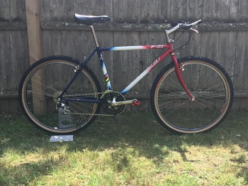

Thanks all - I took the plunge like Markoc - to scratch the itch. Will let you know how it goes. I still owe everyone a thread on the Ritchey P-21 which is now finished - so after that I guess :rolleyes:
