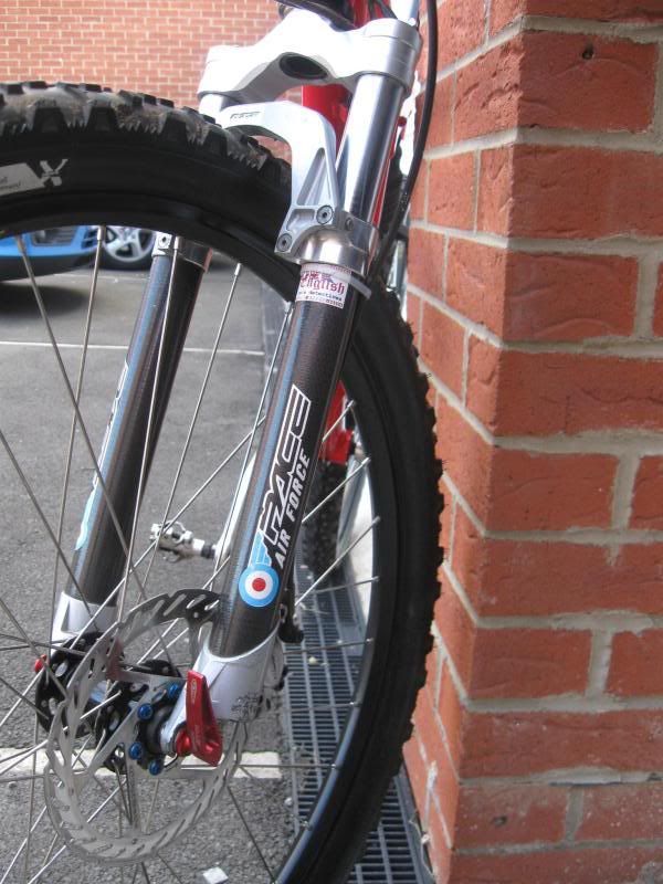

A few more recent pics, a few changes made, still rides nicely :)
ProFlex
Looks really good!
