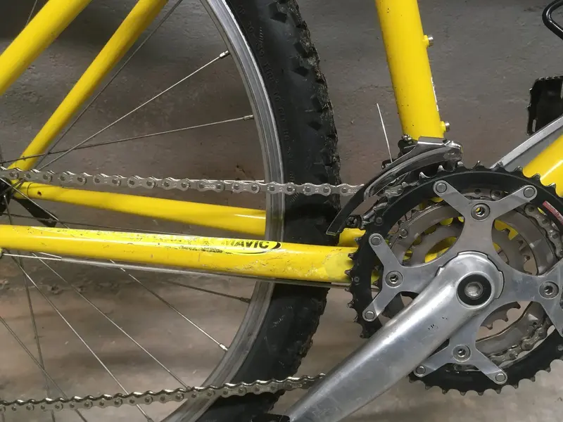

What about treating the rust with converter like kurust or vactan then slapping an appropriately sized chainstay protector over it all?
Well, when your paint dissolves the base coat… you get interesting IMG_3308.jpeg results … at least it does not look too bright
The area that's marked seems to have a nice, natural section that's flat. I'd sand it a bit, build up some primer to help creat a flat surface (unless you want to flat it first), then I'd mask an area just larger than the flat bit. Spray in as close a colour as you can find, fine sand the over spray on the stay so it's flat and blended in. You may not notice the difference in colour much at all. I'd perhaps clear cost the whole stay. Fit chainset, stand back and see if you can notice much.
You were right. With the chainring on it does not look too bad. It will not be my most tidy bike, but compared to where we started… IMG_3381.jpeg
