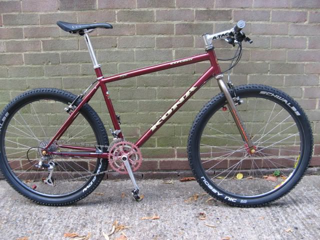

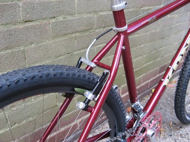

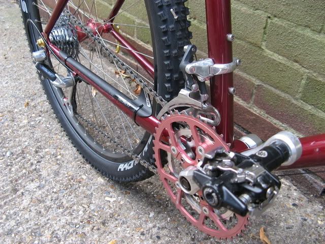

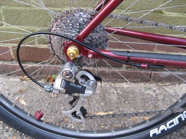

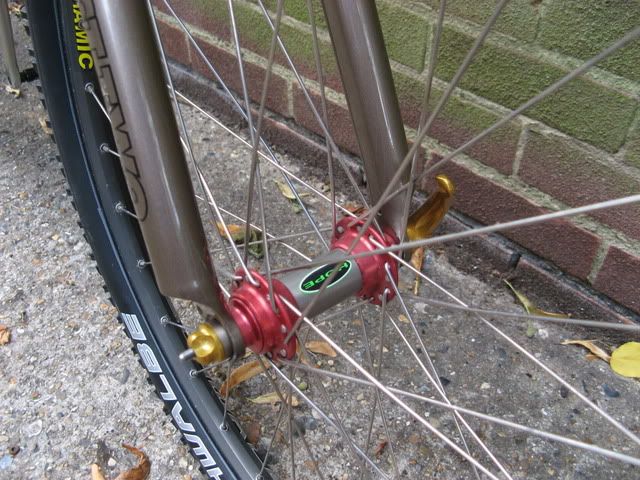

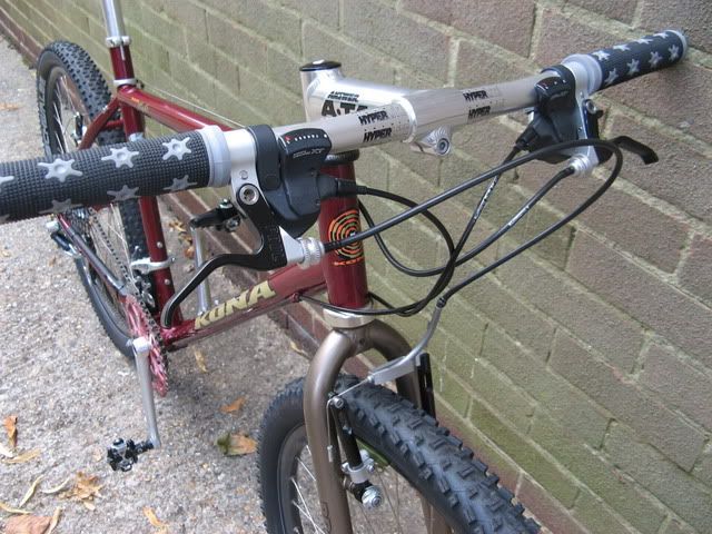

OK I've swapped the forks for bronze triple butted Project Twos as I already had some - not sure if the grey / silver ones would look better. I've also changed the pads for ceramic specific ones which look a bit odd but should work better. I've only had a quick ride but it felt fast if a little twitchy - according to the bathroom scales its weighing in around the 22lb mark. Maybe I just need to get used to riding rigid again :) Anyway some pics:
I think the pace looked OK and proclass2's would look amazing with a gold big ring to match the stanchions.
Like the look of the bike with the bronze P2's however. They might be a bit short and were originally for earlier (pre 95) Konas. I think the later grey ones were a bit longer and should make the handling less twitchy. I could be wrong but hopefully someone else can clarify things better.
Loving the build. Gorgeous :)

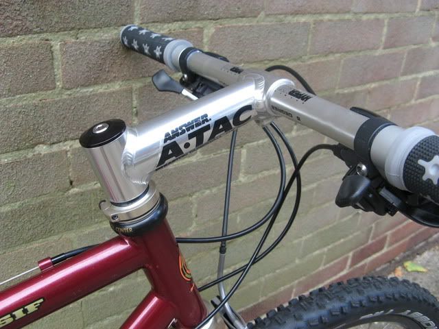

Fantastic with the P2's on. Just need a CT stem to match the post and you have the perfect bike :cool:
I did wonder about the axle-to-crown length of the forks too. I think they are from 1994 and that they would be the same as those from 1995 - the 94 Explosif came with Marzocchi XC500s and the 95 with XCRs I believe and I don't think theres any difference in the axle-to-crown lengths of those. I actually have some XCRs (steerer too short for this bike and I didn't like them much anyway) so I will have a measure. These P2s are 405mm if that means anything to anyone but I guess regardless a longer fork will make it more stable.
Edit: Looking back I see AndyR's 95 Explosif has 405mm P2s so I guess they're right.
I agree a Control Tech stem would look good too and a silver CT bar went on ebay recently. I always liked ATACs and Hyperlites though.
The a-c length of Project 2s was 39cm up to 1993 and 41cms from 1994 onwards. The forks you have on the bike at present look as though they're 1995 P2s.
The frames from 1994 onwards were built to have a 71 degree head angle with a 41cm a-c fork, irrespective of what fork they were sold with. i.e., your frame would have exactly the same head angle if fitted with a 70mm Pace as a 1998 Explosif would have with the same fork.
Essentially if you take a 43-44cm a-c suspension fork and take account of sag, the a-c comes down to not much more than 41cm anyway. And that's only in 'just riding along' mode - it'll fall below 41 momentarily under load. That's why Kona kept the same frame shape for all those years, and just reduced the stem length to suit as fork a-cs became longer.
In fact the long stem you have on there at present is likely having just as much effect on the steering/handling as a longer fork would have. It may be ok for the P2, but I would fit a shorter stem to make best use of the Pace.
