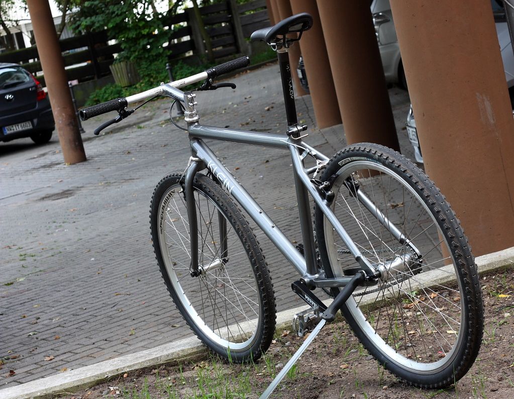

Here it sits as of right now:
LX Cranks w/ 38T ring
KMC SS Chain
18T rear cog
XLR Tensioner(cheap and does its' job)
LX Canti's
Dia Compe PowerControl 7 levers
Tune Titanium skewers - wheels & seatpost
Ritchey ForceLite stem
The other stuff that is not mentioned is temporary, such as:
The Airlineone/Shimano wheels...i'm eyeballing some wheels on mtb-news BUT I think I wanna buy new. I gotta price on some Mavic crossride's for rim brakes. A good price for their weight of 1700g. If anyone has anything decent, then PM me. I'll also be picking up a set of Schwalbe tires suitable for road and light offroad riding. They have some good selections in the 450-500g range.
The whole mismatched mess up front....I wanna go MC1 or perhaps a threadless Ritchey fork if I can find one. The quill stem adapter w/ the threaded headset looks nasty and I wanna clean it up. I have a NOS Ritchey Forcelite bar on the way. Then i'll pick up some Ritchey grip as well(had them on my Stout and liked 'em).
I'm alwaya on the lookout for a set of DiaCompe ss5 levers. The PC7's are for grip-shift and will look a bit odd next to the skinny grips.

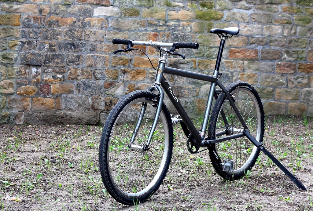

Well, I finally got around to installing some of the parts I had and was waiting for.
Cliffnotes 1st:
Pre-Purchase condition:
Confused:
Getting there:

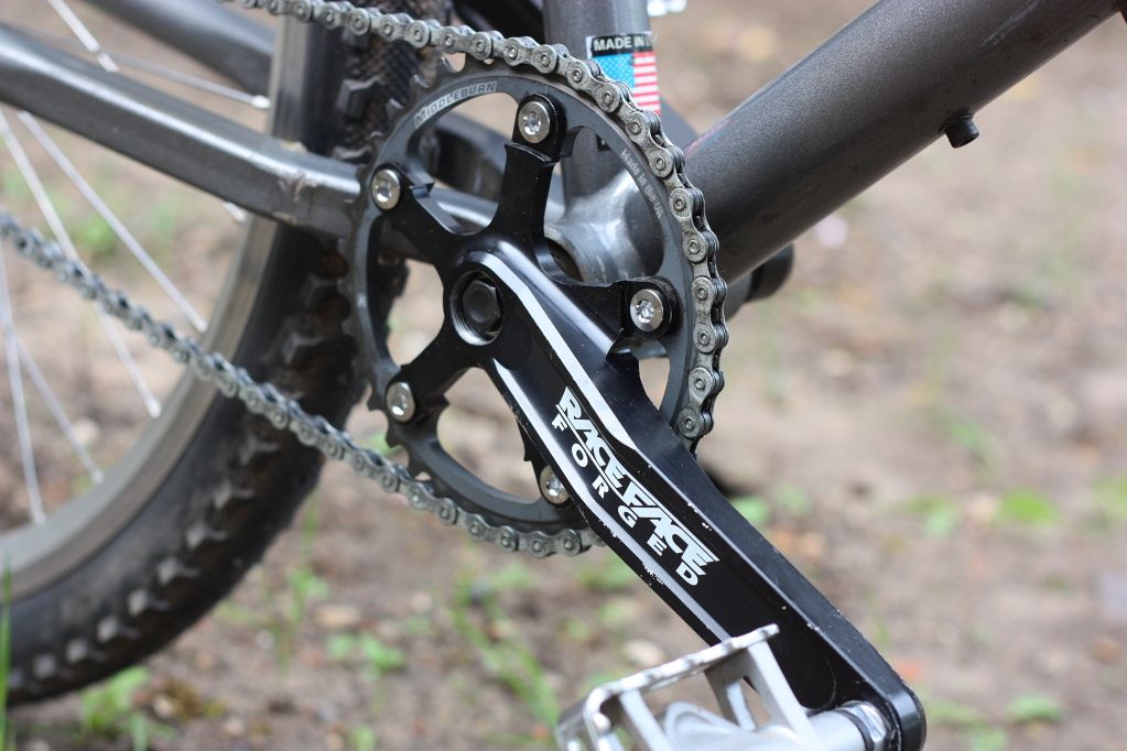

And to today...I had to ditch the LX cranks I had JUST bought because(unbeknownst or undisclosed at sale) they had a bad non-drive taper. I found a set of very good shape RaceFace standard 2x cranks. Also added a Middleburn 36t ring, kept the 18t rear and the KMC 9spd chain. I removed one link and got the tension just about right with the wheel sitting all the way up and ditched the spring loaded tensioner.

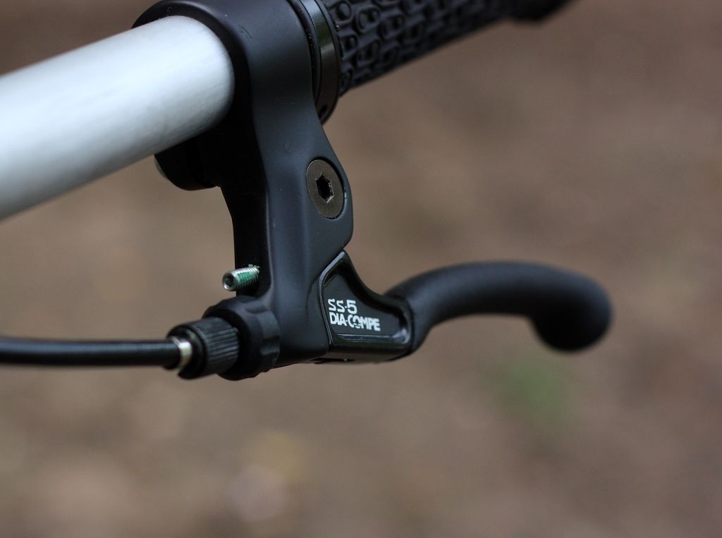

I picked up the DiaCompe SS5 Levers from another Retrobiker and the NOS Ritchey Forcelite bar from an mtb-news'er. The bar is 560mm and I typically like something a bit wider. I'll be keeping the lock-on grips. I run them about an inch over the end of the bar to widen the grip, an effective 50mm or so, it's just enough.

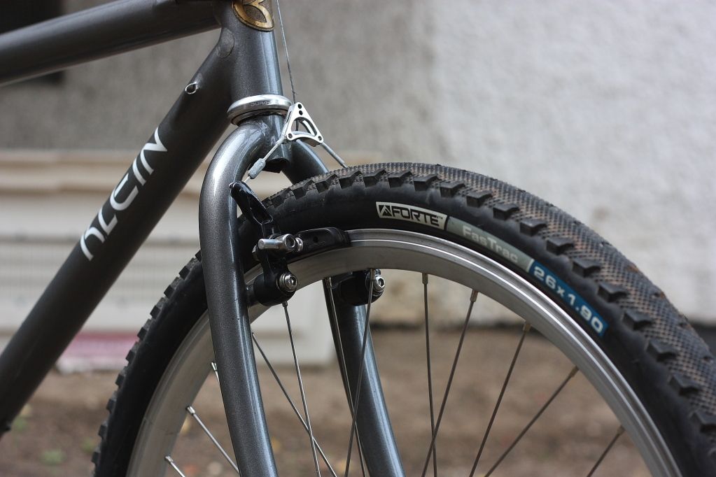

The MountainKing's weren't doing it on the street so I swapped on an old set of Forte's I had lying around. At 410g, they're a bit lighter than the Conti's.
BTW...see my sig....
The frame looks to be in great condition. Not a big fan of SS but this bike looks good.........but why don't put a decent pair of cantis on the bike? A true Klein deserves that. :) M737 or M900 cantis are available at reasonable prices.
