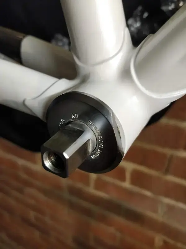

DA 7400 BB fitted and spinning butter smooth. 🤟

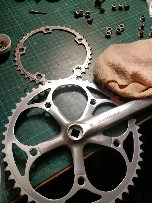

Cranks cleaned up and NOS large DA chainring fitted to the 7410 cranks to replace the knackered TA one the cranks came with. The bolts were shot as well (and inner chainring fitted backwards!!) so I've replaced them. The inner ring has some wear but is staying for now.

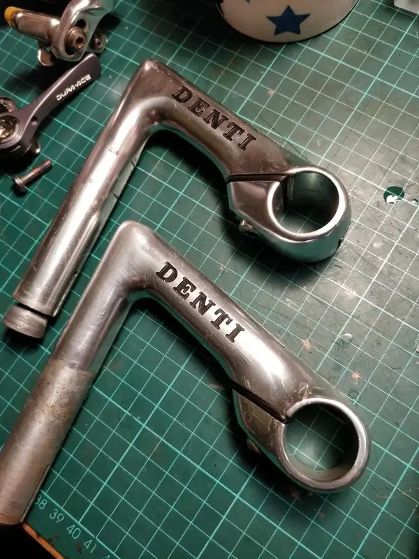

I have the choice of two panto stems for this, see below.
The shorter (and older version of the Record 84) has a square D panto on the nose but nice though it would be to have this detail I prefer the 120mm. Both stems have been cleaned up, bolts wire brushed and everything greased and polished.

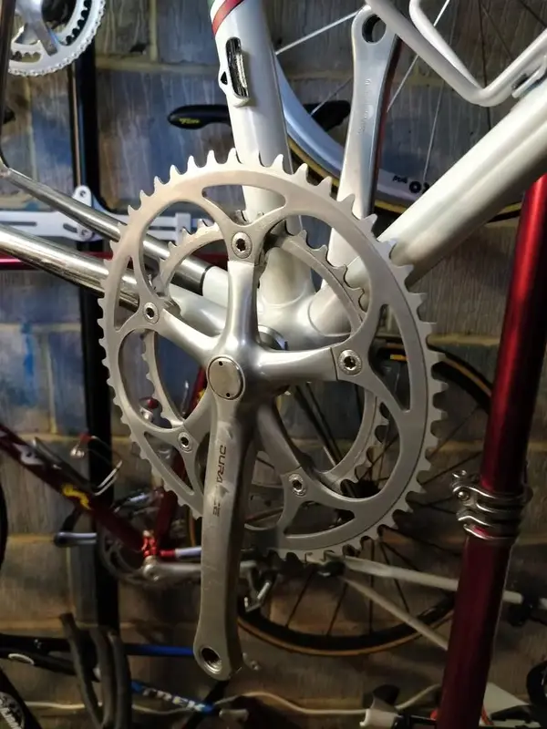

7410 Crankset fitted;
I believe the 7410 cranks came with their own bolts rather than standard bolts with a two pin dustcap like these - anyone able to confirm? Am pondering hunting down the correct bolts if so, although this isn't a perfect period build and I quite like the look.. hmm.

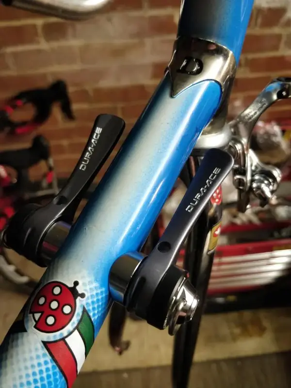

Some NOS 7401 downtube shifters.
and fitted;

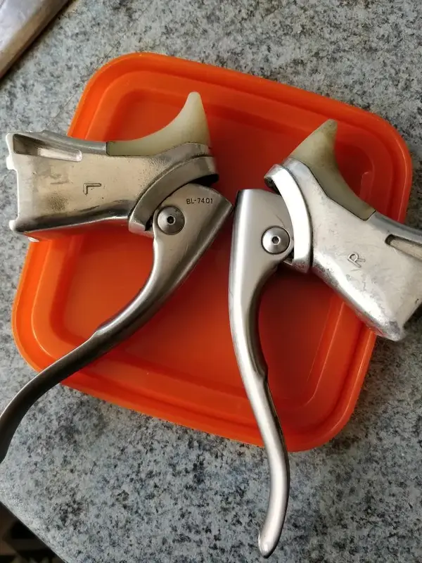

I have a pair of 7401 brake levers that are rather scratched and I'm in the middle of restoring and polishing. With that in mind, these will be the only part on the bike with the DA grey/blue anodizing. They are lovely but I am tempted to get hold of another set in worse condition, strip the anodizing and polish them to match the alu and chrome better. Any thoughts?

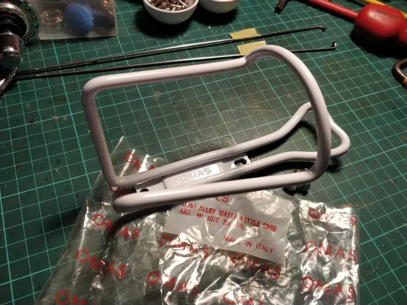

Finally I have this mint 80s OMAS lightweight bottle cage to add a touch of the exotic; I have a couple of other possibilities for cages so will see what they all look like when the build is otherwise complete.

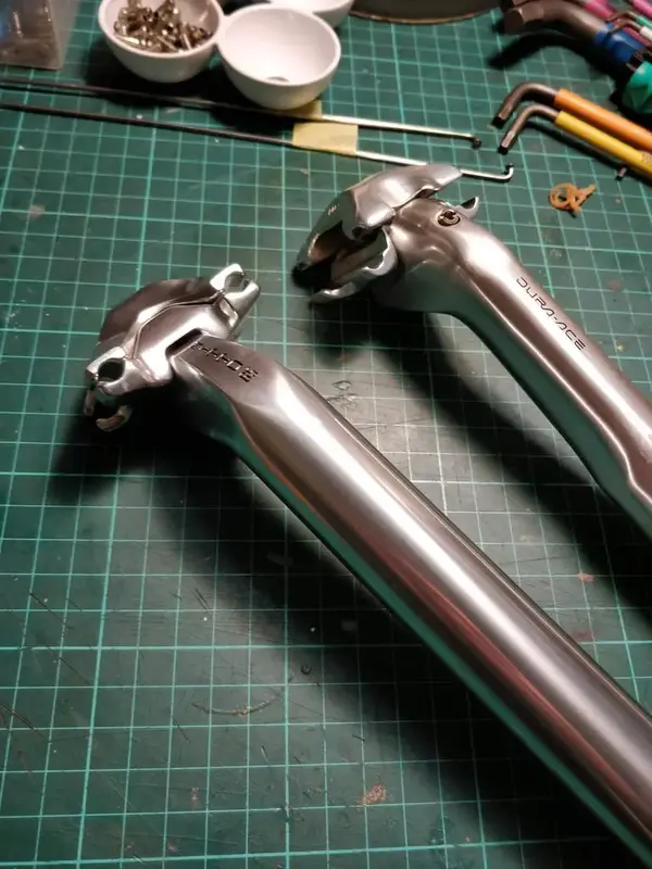

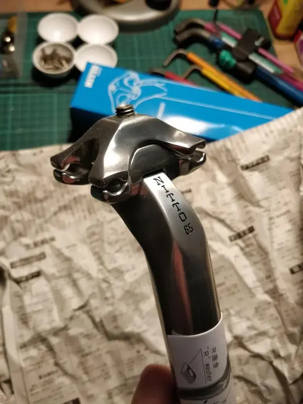

A few more evenings spent tinkering this week. My beautiful Dura Ace aero seatpost is too short for my long legs with this frame, so I bought a Nitto S65 as a suitably classic looking replacement.
It came packed in what looks like the Japanese equivalent of the Financial Times!
The quality of Nitto's metal components is absolutely superb. Well worth the money in my opinion.

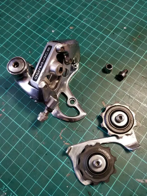

The DA rear mech I have has a few scuffs and marks so I dissembled and cleaned it and started work polishing out the worst scrapes.

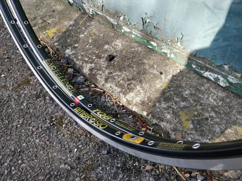

I am going to build up my DA 7400 hubs with Ambrosio Excellence rims; I bought a modern set which look like this;
The graphics are too flashy and modern for this build so I sourced an excellent set of repro vintage decals from Ebay.
After painstakingly scraping off the old decals, cleaning the rims and then affixing the new, they look the part!
Very happy with these and now ready for some wheelbuilding next week. :D

DA 7401 levers about to get their (scuffed) anodizing stripped. I'll post some pictures when I've polished them of how they are now, but I was super impressed at how easily a caustic soda solution took them back to bare metal in no time. Gloves, goggles and a good respirator a must though!

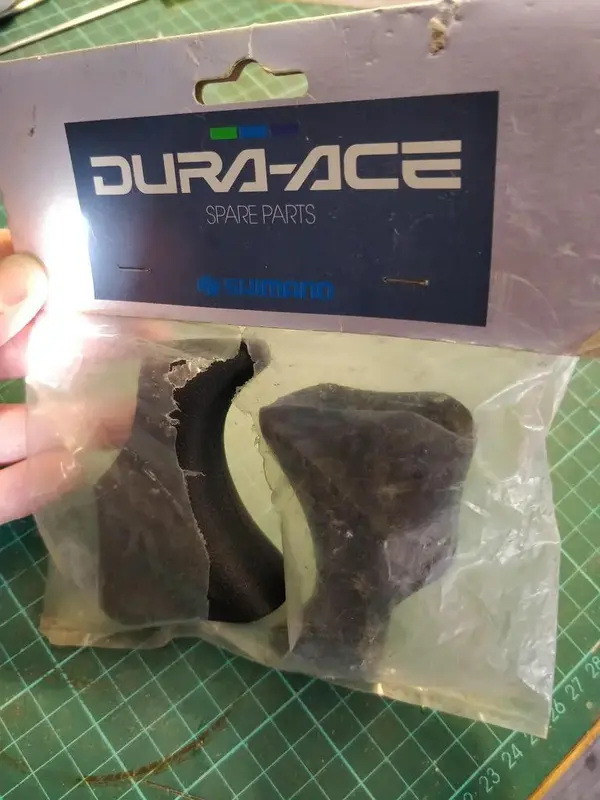

Next up for treatment were these NOS hoods I picked up. Perfect condition, if a little greyer from age.

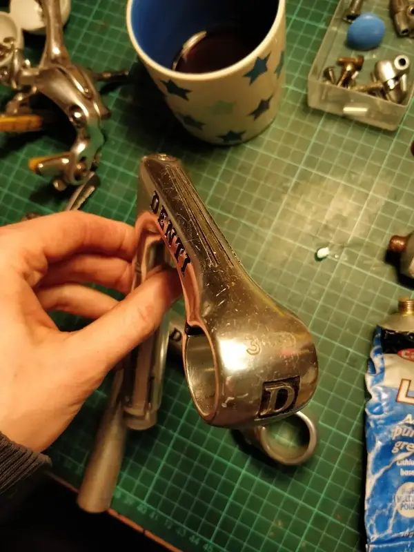

I was missing the top caps from both stems so I drew up and 3D printed a replacement - this will be sprayed black before fitting.

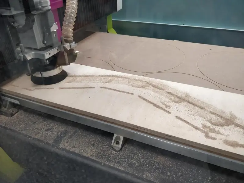

Working from Roger Musson's excellent book, I built his truing stand and accessories ready for my wheel building. This is one of the parts of the build where I really feel I'm working to level myself up and properly learn something new! We have a new CNC machine at work so I drew up the parts and put it to work chopping them out of some thick ply.

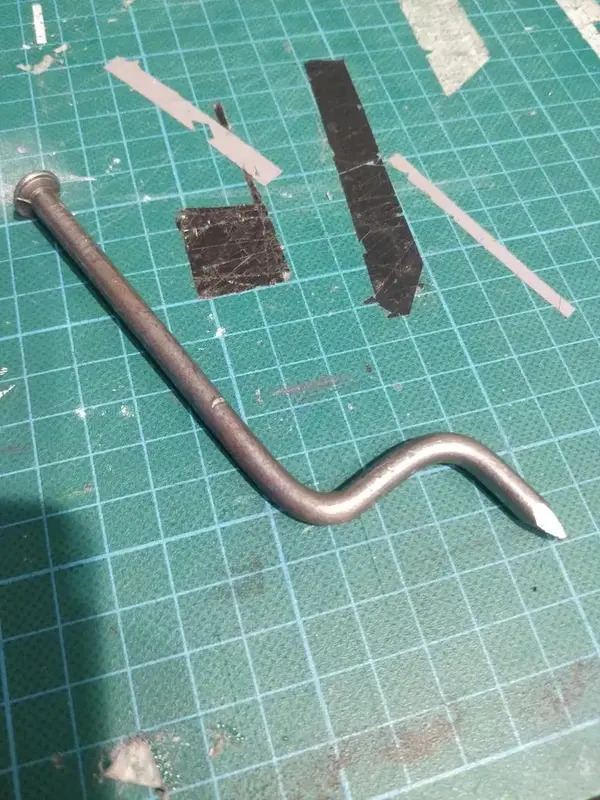

I made my own nipple driver from a thick nail and an old file handle. Very satisfying to build your own tools.

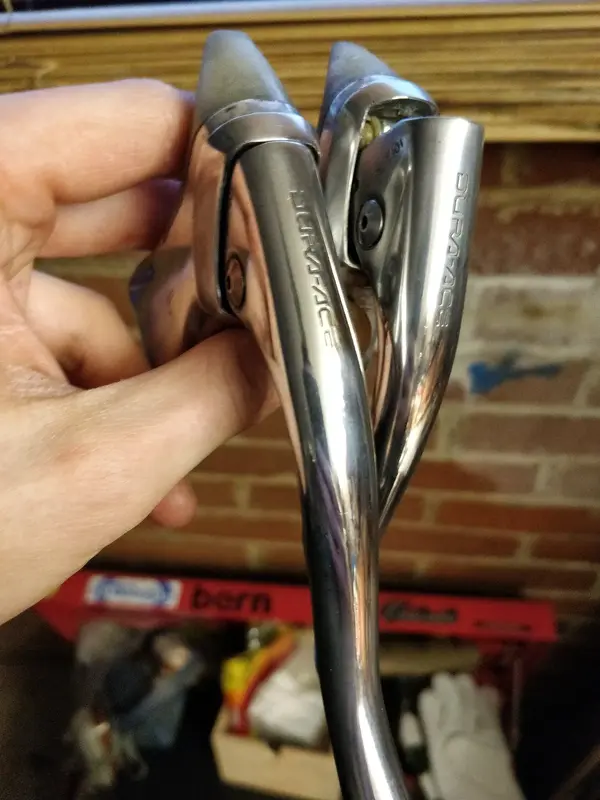

Anodising stripped from the levers and the blades polished up. As mentioned in Wanted I am after a clamp band for these as one of them is damaged.
I will give the engraving a paint fill before fitting too.
