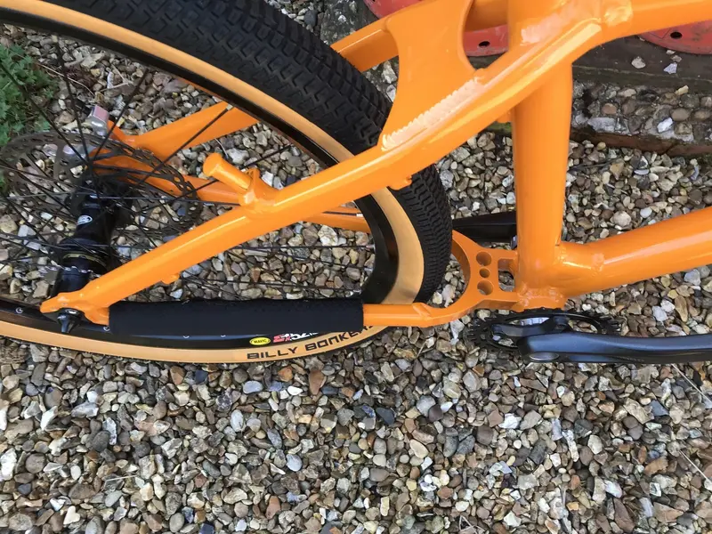

Cranks are on but I think I need to space the dmr sprocket further out.
yes you do. maybe I was confusing. second cog from the smallest, not the largest. :) you can work out roughly where it should be from my above comment. 13mm from the drop out. :)
you know you can remove the brake bosses and fill the hole with an M10 grub screw don't you? much cleaner than the plastic travel caps you've got on now. :)
a quick look suggests the big ring and 1 small on the back side, then the cog, then 1 ring and the lock ring, should get you pretty much in the right ball park.

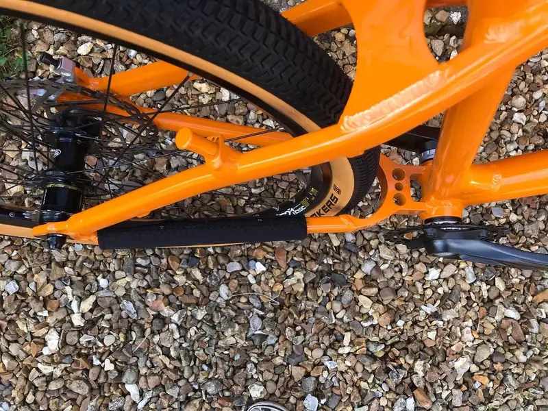

Like this? I’ve had a chain on in place and it looks ok. Ahh yeah the brake bosses. I don’t mind them as it’s a nod to the old school! This frame is a 2nd gen Planet X Jack Flash I bought when they were down to £50… couldn’t say no! Haha
yer, I reckon that will be pretty damn close.
hard to say from a picture obviously, run it and see.
thought it was a shame they didn't make the jackflash with horizontal dropouts, would have made a belta of a frame then.
Cheers, yes I’ll give it a try see how it goes, I don’t think it’ll be as an extreme angle as a 1x11-12 in the lowest gear. It’ll hopefully be just fine!
