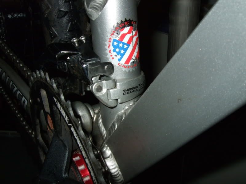

i have a set of Race Face Prodigy cranks that i had earmarked for this bike,
i needed to get a bottom bracket to suit them as the one i have is a 68mm,
but this frame is a 73mm shell, so todays search of all LBSs came up with zero
there isnt a 73mm shell bottom bracket on the fylde coast for sale
so..
i took the Race Face Ride XC and Hope external BB off my Saracen Tufftrax,
the Prodigys and standard BB went on to replace them

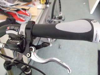

also while out today i bought some grips to complete the front end set up
perhaps controversially some Ergon GP1-S, i've been toying with the idea of a pair of these for a while,
and after trying a pair it had to be done

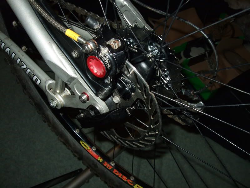

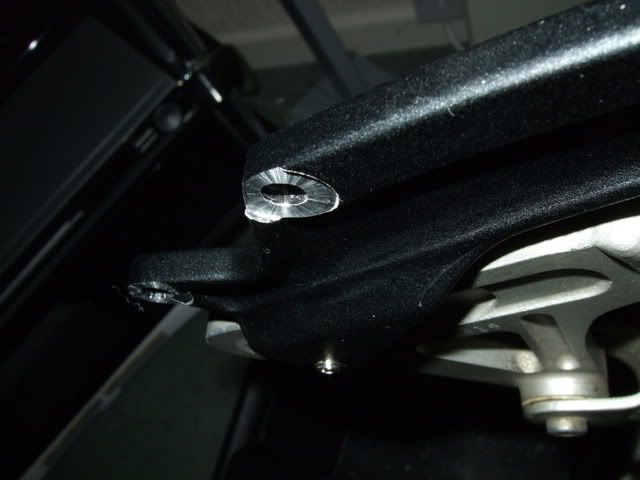

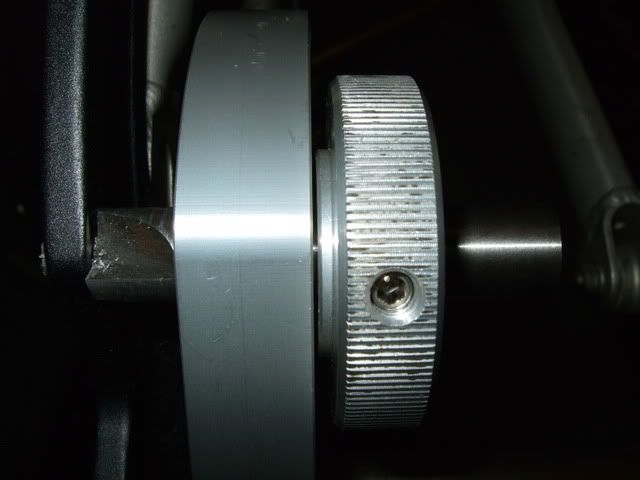

next job will be facing the Sharkfin adapter with the Hope Spot facing tool
as there is quite a lot of rub and no adjustment for the caliper

got a pair of those grips on my other half's GT that used to belong to me, Loz. I think they're amazingly comfortable, especially for the longer rides.

today saw a slight change of plan with the rear disc.
i didn't think the 180mm rotor looked right, so i have put an avid 165mm rotor on and a hope mono mini off my Saracen, the M4 has gone onto that.

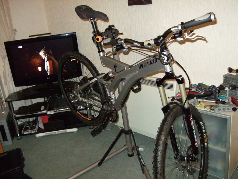

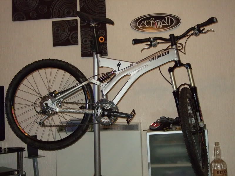

after a rummage in my spares box for some outer cable and some coloured cable ties here is the finished bike
no doubt it will evolve slightly as it gets used, or if the right parts come up :)
now get out and ride it.
i honestly cannot fault my 98 FSR it rides so well

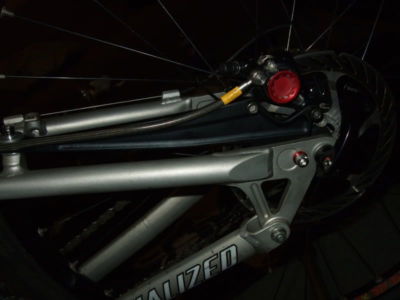

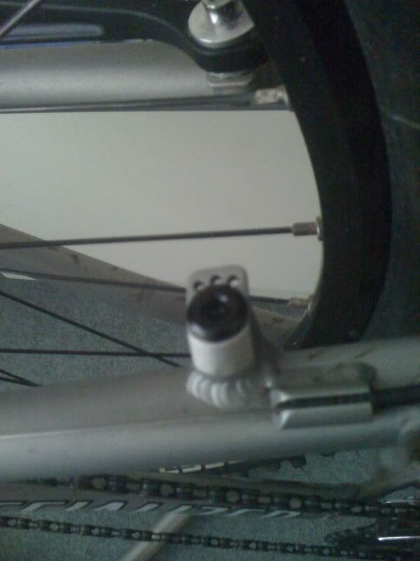

I've got a hose guide for the front end and a blanking bolt for the right hand seat stay brake pivot delivered from chainreactioncycles
I had to tap out the frame for the M10 brake blanking bolt as one of the previous owners has forced in a narrower threaded brake post making a mess, all good again now though :)
