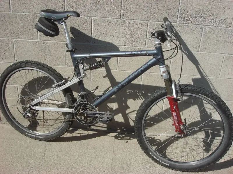

Sorry all for revivin' an old thread but I have to know what happened to Karloff70's Psycle Werks Wild Hare... 3 pages of posts, nightmares, and updates... and nothing else. I have to know if Karloff70 got his Wild Hare rollin' or did it burn up? What's the story, man?
I live in Southern California, home of Psyscle Werks, I recently acquired a Psycle Werks Wild Hare, love the bike, and have found this old thread to be the most informative thread on any forum. I gotta have some answers...
Thanks again and forgive the revival!
Peace'fo'real,
-D-
